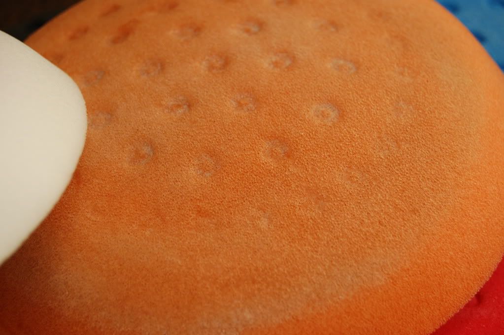

Here is a continuation of the review.
The pads are washed. I washed them so I could show the wear of them after just ones use. IMO, they are quite worn. If you look at the outer rings of the pad, you can see the dimples are disappearing quite quickly. Mainly on the orange pad, but the white seemed to show significant wear as well.

With the wear that the orange pad is showing already, ad the fact that I did not need much pressure or speed to complete this detail, I am wondering if they would hold up for a larger vehicle like an SUV.
I am going to give these a try again on another car on Saturday just to see how long they truly last and cut. While this does not matter on a single use pad, I am doing for my own curiosity.
Did the dimples disappear because the foam was worn away? Or did they kind of "pop" out?
Wow.... that much wear after one use? I'll be curious if others see the same thing. That doesn't exactly make me want these if they do wear out that fast.
Hey you're supposed to throw them out after one use! ;)
I'm aware of that, but even a normal pad doesn't wear like that after one light use. By the time he got to the last panel he buffed, the cutting power would have already been significantly reduced from what he had on the first panel. Any semblance of affordability is totally gone from the system if it takes 2+ throw-away pads to complete one vehicle with consistent cut from the buffing equipment across all panels.

I'm not arguing with you, and I know you're just playing devil's advocate (or would that be LC's advocate? :laughing: ), but it just seems ridiculous to me that they would create a system of one time use pads that seemingly can't even stand up to enough section passes to complete an entire vehicle before exhibiting signs of significant wear and reduced effectiveness. Especially when the operator specifically says he wasn't being very aggressive throughout the buffing process!
Having said that, I do seem to recall MP Cobra Fan saying before he got the pads in that this was his first time using a rotary buffer, so we can't be 100% sure technique didn't play some role in the way the pads wore. Judging by his results though I don't think that was an issue. We'll have to wait and see if others see similar behavior from the pad system, and I'm especially interested in seeing how they behave for rwright on his DA.

Past that, even "high end" detailers might find that the system isn't very cost effective for them if they end up going through multiple throw-away pads during each step of their buffing. I'm not sure if the guys you mention tend to switch to a fresh pad every panel or two already when using traditional pads, but with the amount of wear the 1-Pads seem to be exhibiting it would appear as though they'd almost have to change pads more often when using this system -- which with the pricing set as it is could actually increase their overhead costs when doing work for a client. I don't think even a guy like Paul Dalton would like seeing their profits eaten into as a result of using a different buffing system.
I too will be very interested to see how people respond to this system as the "new toy" phase wears off. Call it a hunch, but I bet we'll see LC dropping the pricing of the pads or working to revise the foam they use before too long, especially if many other people experience similar wear patterns to those shown in this thread.
