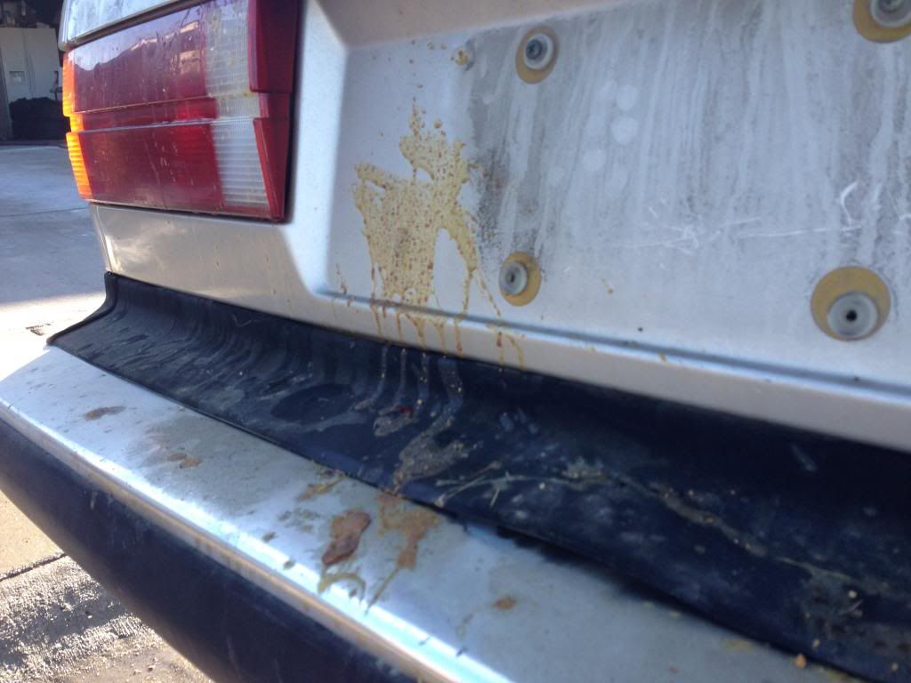

I acquired a 1985 325e for $550 a few months back. It sat in the previous owners garage for "3 years" (although I think 6 years because that's what the receipts I found in the car told me). Being from 1985, it doesn't have a clear coat. And it sat in the sun a bit causing the paint to leave on the hood, roof and trunk. And the trunk is in question today. In the process of sitting for 6 years, I believe someone to have thrown up on the trunk as seen here:
Gross stain

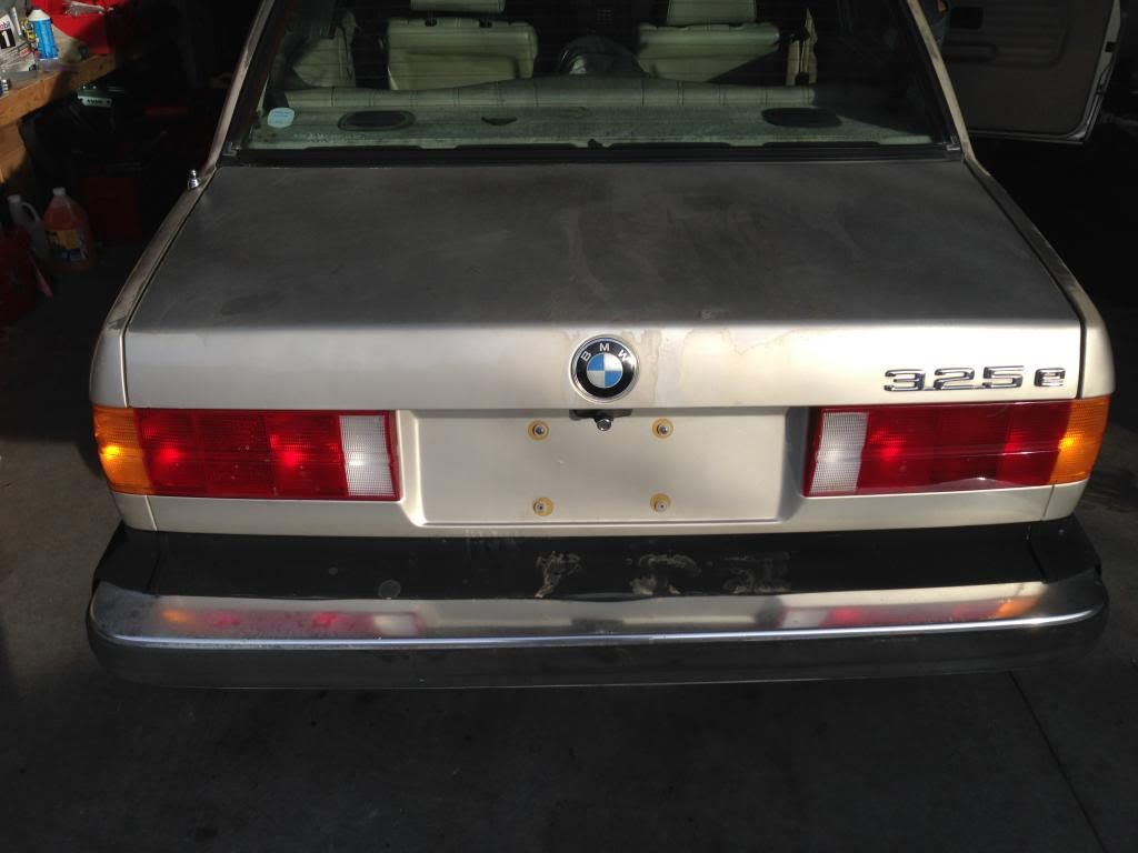

And the best picture of the trunk I could find.
Anyways, I want to repaint the trunk. One to test out my painting/detailing skills. And two so my detailing vehicle is presentable.
