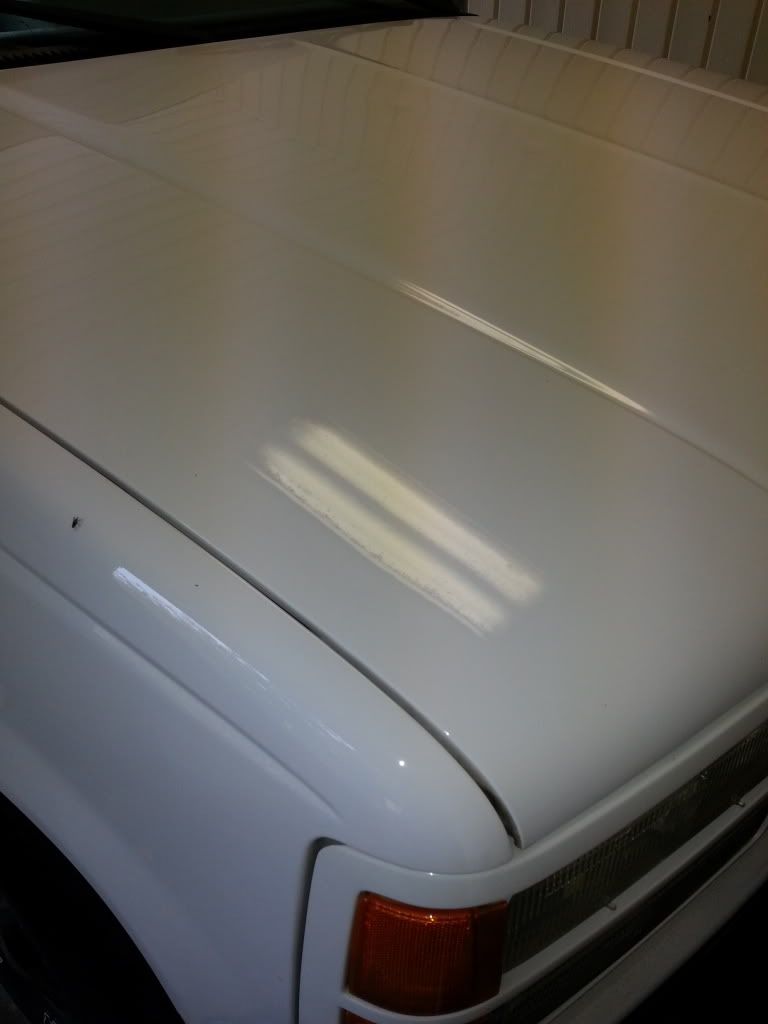

Here is my 17 year old GMC, I bought it new, the paint is factory and has always been parked in the sun,the outdoors.
The shine speaks for itself, this pic was taken 2 weeks ago.
I wash it weekly.
Wax it every two months.
Clay it every six months.
Rinseless wash daily.
I also make sure to keep it sealed which is a plus.
Shines just as good as my new car.
It's all about maintaining the paint.
