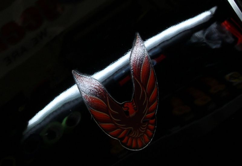

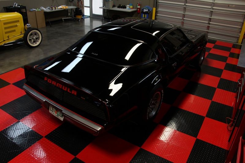

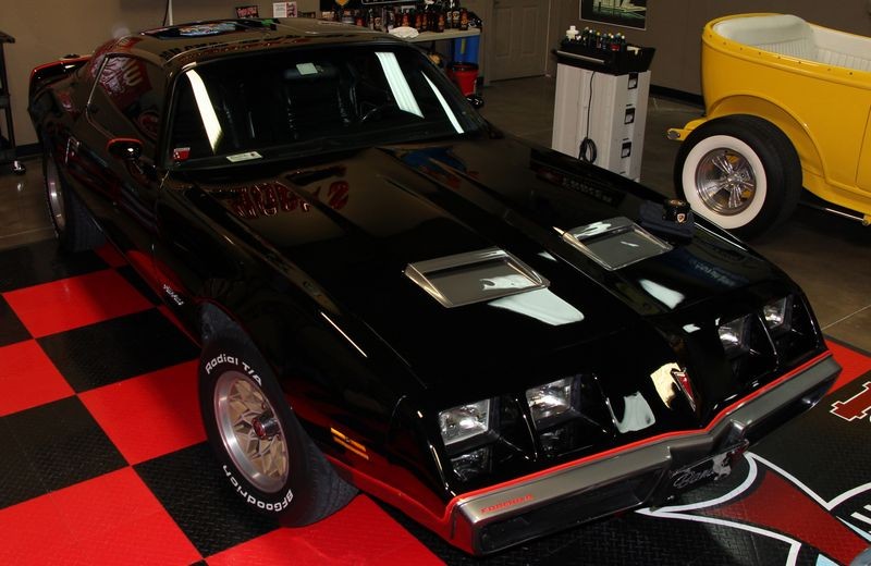

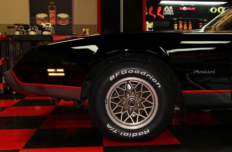

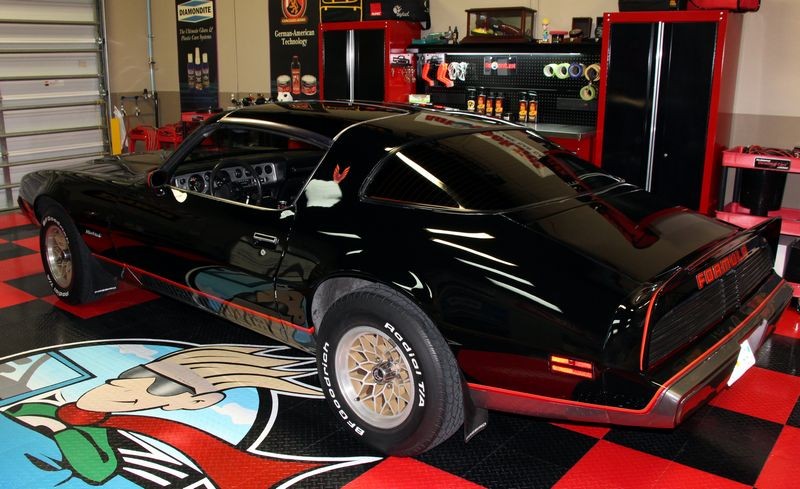

This lexus came initially came in for a 1 step polish to remove light swirl marks. After inspecting the vehicle after a thorough decon step and car wash, the car was in pretty bad shape. The paint tends to hide swirls and scratches really well, but shows hazing and marring in direct sunlight. The correction took longer than expected since even my softest microfiber towels was marring the paint with each wipe down after polishing. Decided to use essence diluted with distill water. Using this combination allowed no marring when wipeing off the polish, allowing me to jump on to using Gloss Coat. Here are some pictures! Very difficult to capture scratches. EnjoyView attachment 56813View attachment 56814View attachment 56815View attachment 56815View attachment 56816View attachment 56817View attachment 56817View attachment 56818View attachment 56819View attachment 56819View attachment 56820View attachment 56821View attachment 56822View attachment 56823View attachment 56824
