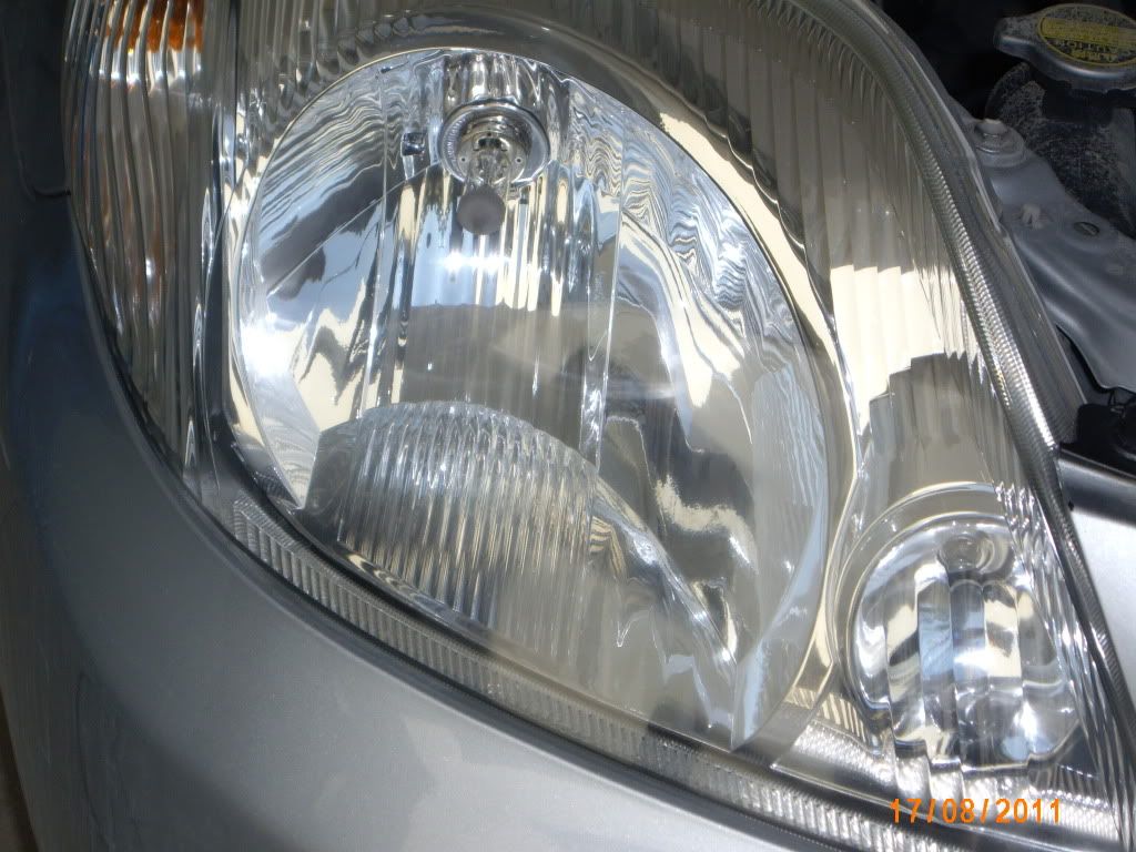

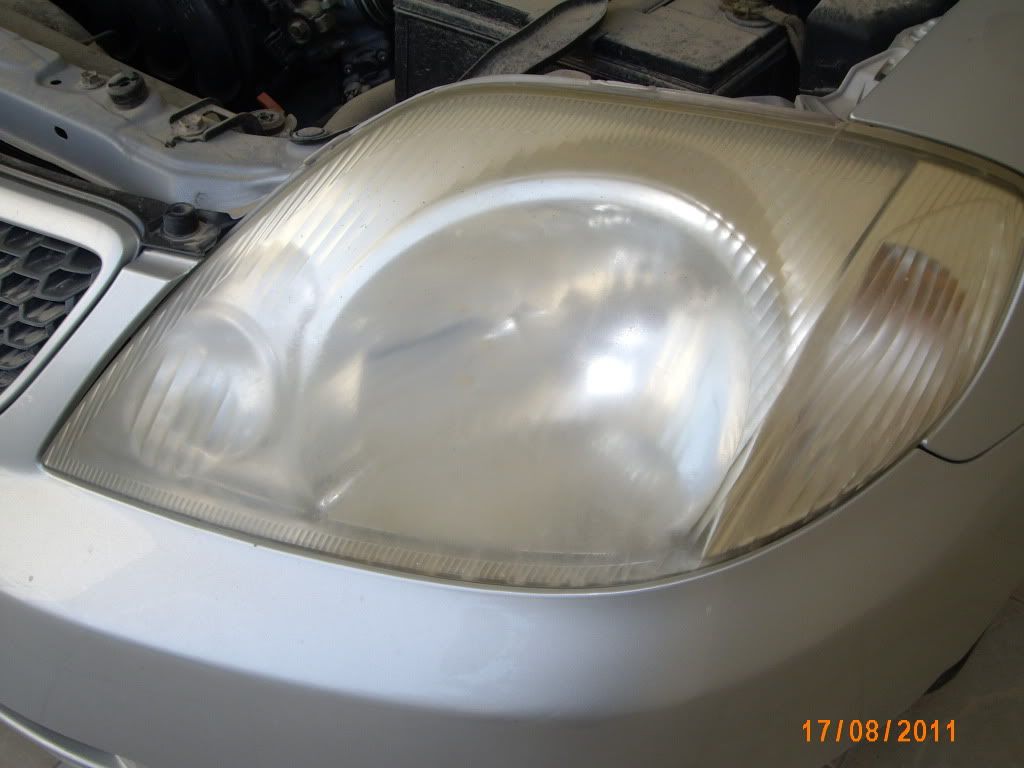

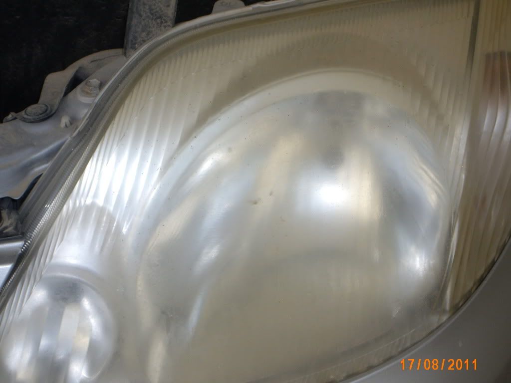

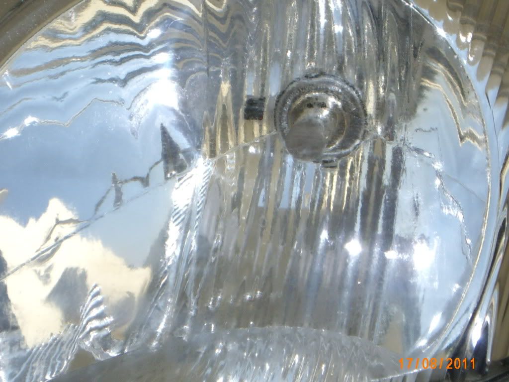

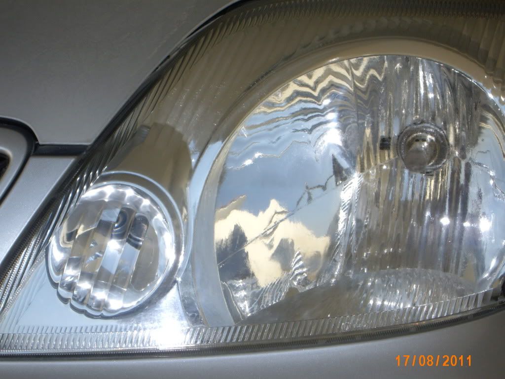

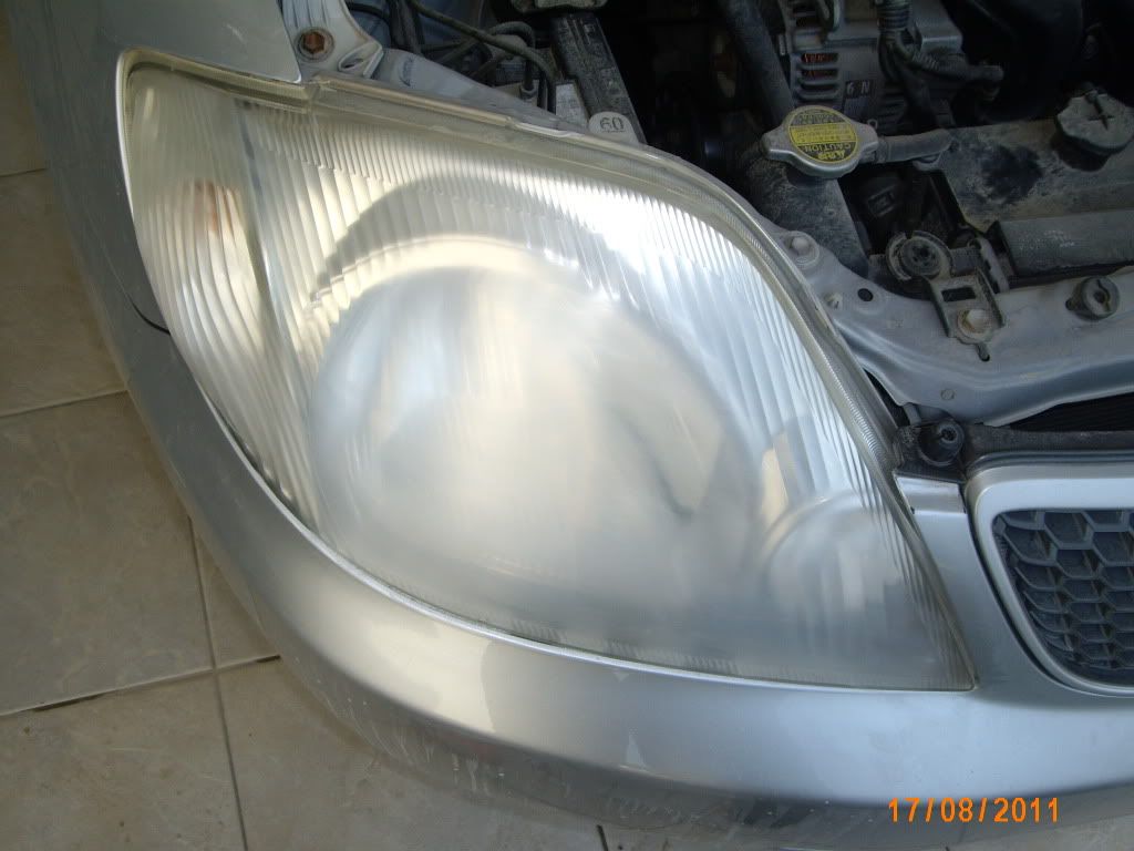

I polished the front lights of a friends car. I started with 2000,2500 and 3000 sandpaper.Then polished with orange 4 inches edge pad and extrem cut and finish with blue pad (same brand) with some evolution polish and merzena 85 re.
Protection optimum optiseal and optimum spray wax
And the left one
My first time tried to polished lights with sand paper but i believe i made an improvement .
