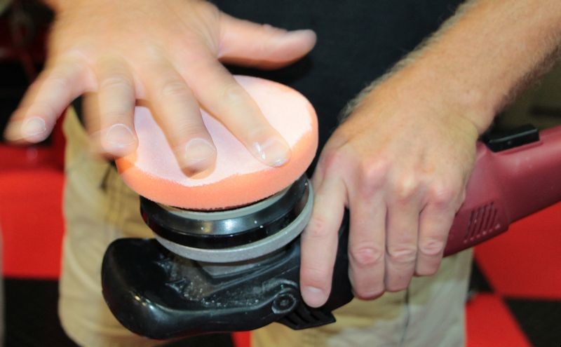

I'll be showing how to remove the scratches with the following tools,
  1. Rotary Polisher
  2. Short stroke polisher
  3. Long stroke polisher
  4. Gear-driven polisher
