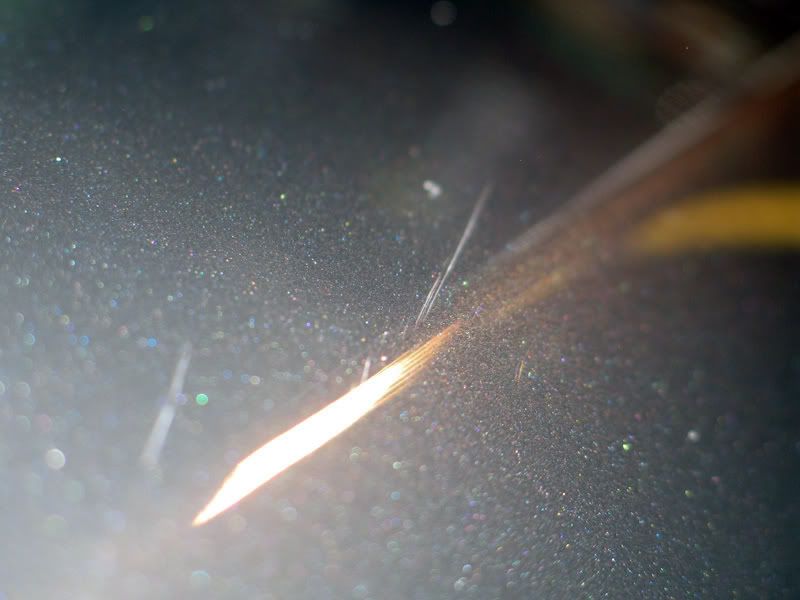

And a close-up of one of the areas of damage. It was dark and really tough to get a good picture. It was worse than the photo looks. And there were four areas with scratches like this.

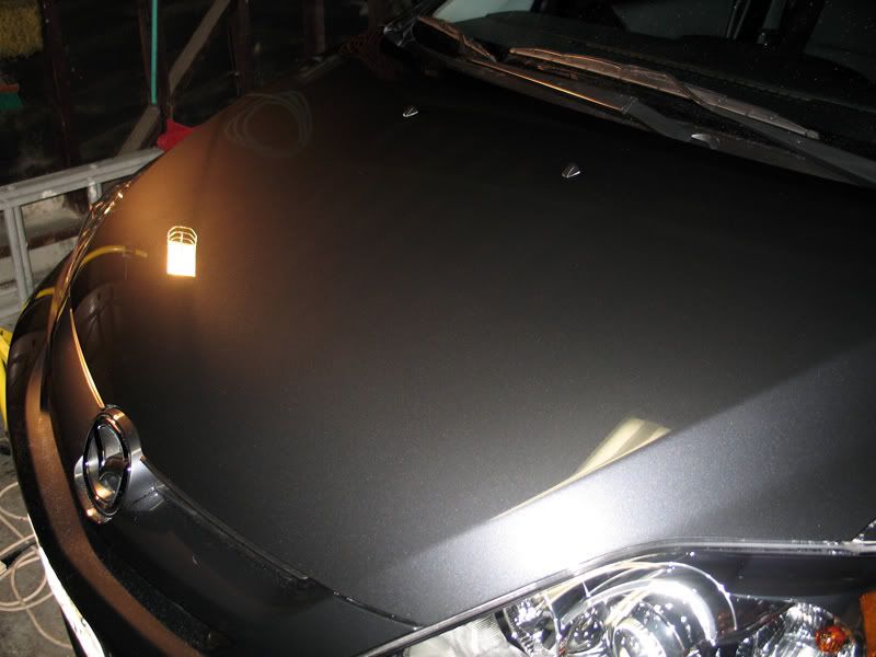

Since the entire hood needed polishing anyway, I decided to do it all. When I have some spare time I'll finish the whole car. It needs it. It's been about 8 months since the last polish.
Process...
Meg's 83, green edge pad @ 1400rpm
OP, white edge pad @ 1200rpm
Natty's blue

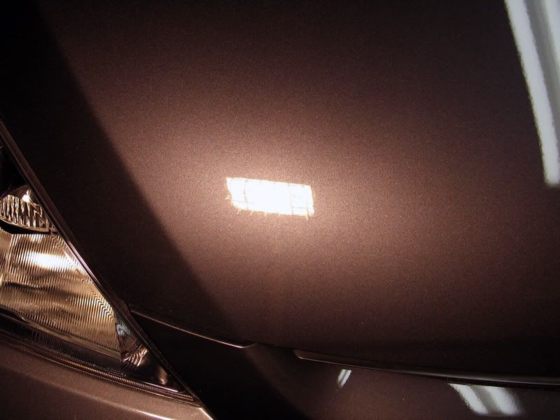

Verdict of the bout between the The Mazda's hood and Sadie's claws...Mazda 5 wins! :awesome:

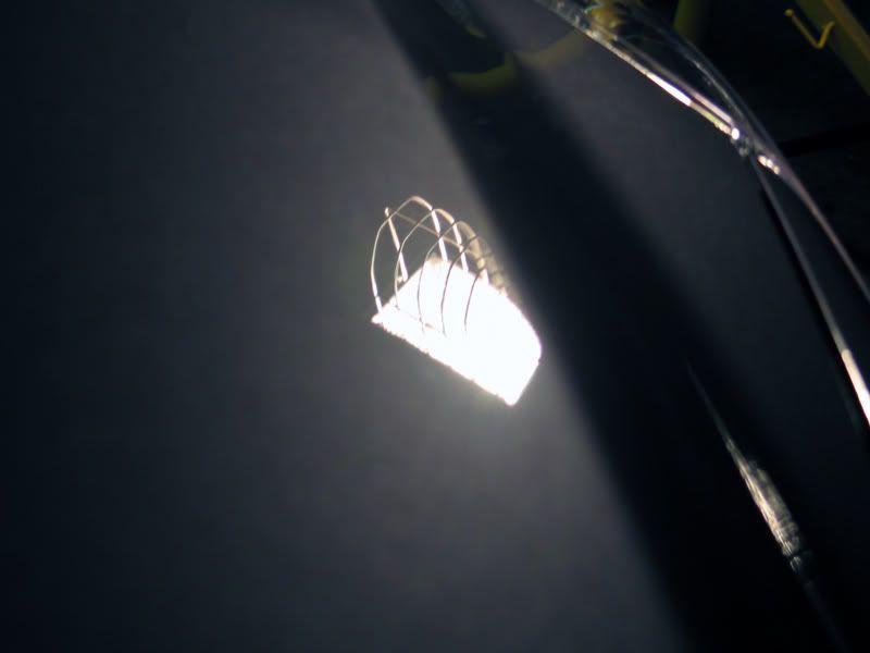

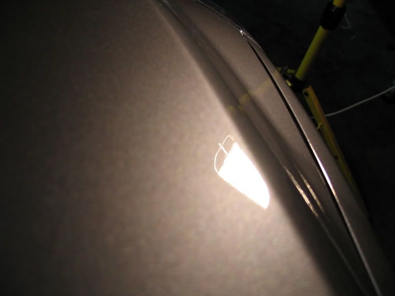

A thought I'd matched pictures pretty well until I uploaded them. Basically the close-ups below are of the above area but at a slightly different angle and out of focus. But the scratches were removed about 95%. There were a couple areas that were a bit deeper and I didn't want to remove too much clear.
Process...
Natty's blue
