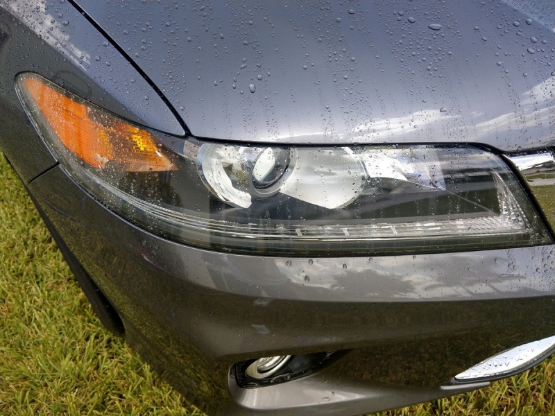

Hello,
Ive tried several different headlight protectant products. Meguiars, Mckees37, even CarPro Dlux (which is more of a coating). Never been truly satisfied with any of them. Dlux did last maybe a year or so before it started degrading. The protectants seemed useless to be honest, not providing much in protection against UV damage.
I was eager to give Mckees 37 Headlight coating a try.
As would be required, I polished all the oxidation off my headlights (I think I used a compound actually), and then cleaned the surface to rid it of any leftover oils.
The coating was as easy to apply as any of the sealants. Wipe on, spread out and then it dried and basically disappeared. I applied it to my headlights, and also to the glossy plastic trim on my doors.
These photos are about 2 months or so post application. Water is still beading nice off both the headlights and trim.
If this protection holds up, and keeps my headlights from oxidating for a while, I will be happy.
This product is very easy to use.
Downside is its on the expensive side. However, I imagine one bottle could do a lot of headlights and trim.

I have no expectations but it surely is 100% easier to apply than Dlux. I think I got a good year and a half out of dlux, but when it was done, it seemed to oxidize and fail really bad. But at 2 months, its still looking good.

Not the OP here, but I applied Mckees coating on my 2016 Q5 and 04 TSX at the end of November 2018. The Q5 I only used coating prep polish since those headlights still look new. They still look new today.
The TSX have all factory headlight protection long gone. I had applied Meg’s headlight coating 2 years ago and they started to look grimy at about 6 months, so assuming that coating wore off after 3-4 months. I did the Mckees headlight polish to get these back to clear again. It’s going on 5 months now with the Mckees coating. Headlights still look like they did when I applied the coating. Will update back here eventually for further status.

I have not deep sanded the old headlights, but still looking good so far. They would typically have started hazing/yellowing by this 5 month mark.
