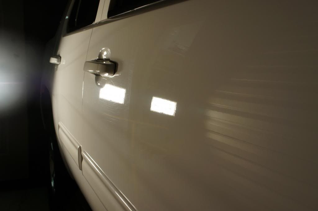

Im giving you a review of the Megs 3" Microfiber Cutting Pads I just received. I had Chevrolet Tahoe to do this morning so I figured I would give them a go.
This is the second time I have done this vehicle for this customer. I showed her the RIDS, swirls, and lighter scratches that were present when she brought it to me the first time. She wanted to get them out but wanted to do it the next go around.

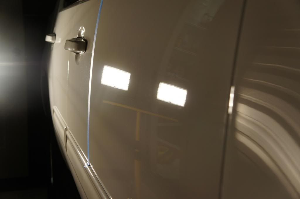

I broke out my Porter Cable 7424 polisher. Granted, this is the old model with the 3.7 amp motor. I have had this thing going on 10 years. I used Megs D300 and the 3 inch backing plate which came right to the edge giving me a "exact fit" backing plate/pad combo. Kevin Brown told me this would give me better control and cut better since all the pad was being used and getting the same pressure.
Note(Im only using the 3 inch pad and plate because im still waiting on the 5 inch to come in. I was only doing the door for her today to basically show what it should look like)
Here are the before and after pics.
after
nice job :) please post pics if you do a write-up!
Nice results. I'm a big fan of D300 and microfiber pads. Also like microfiber pads with FG400 when I need even more cut than D300.
Do you see them? I posted a lot of them. :props:
my bad lol, i meant a complete write-up with pics of the whole car, etc,. :) those pics do look great, keep up the great work...:dblthumb2:
The pics are fine nice wright up I use them all the time.
Just wait until you try out mf pads with that rupes. They are a match made in heaven.
