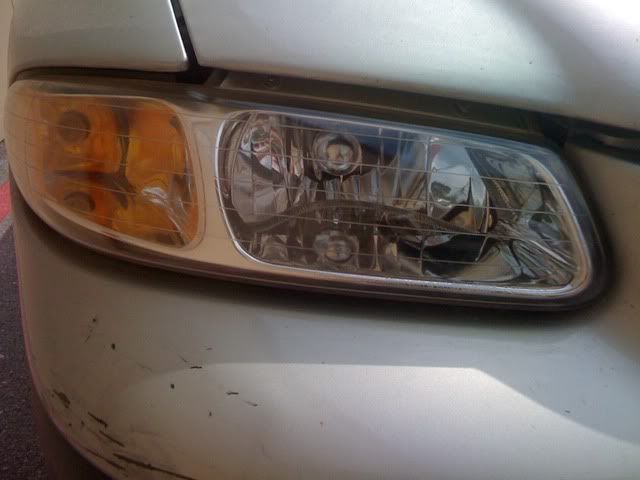

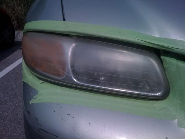

Heres one I know I did with just PG
Before
After
