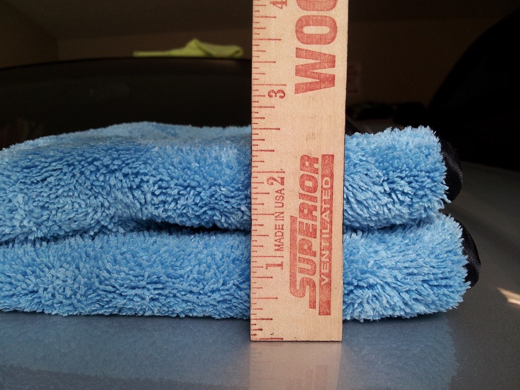

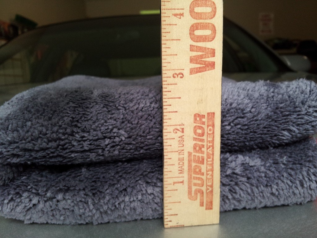

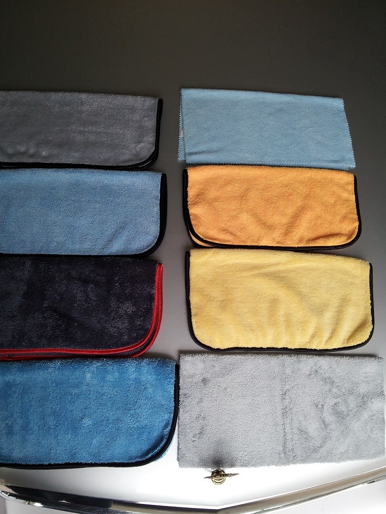

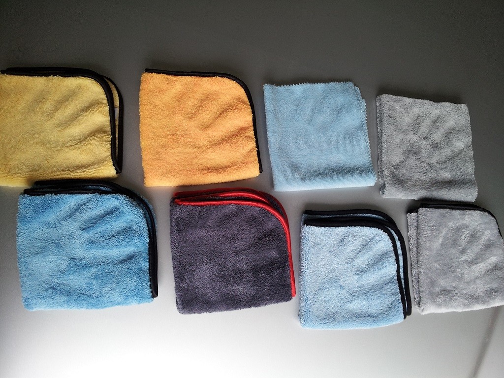

Clearcoats scratch easy. There are other options for chemically stripping paint besides IPA. I like the Wolfgang Perfect Finish Paint Prep instead of IPA.
I wrote a VERY detailed how-to article for applying a coating to paint using the Wolfgang Uber Ceramic Paint Coating and the tips and techniques I shared would apply to ANY coating.
Lots of pictures.... lots of how-to info... check it out...
Review & How-To: Wolfgang Uber Ceramic Paint Coating
watermark.php
watermark.php
KEY TIP
Very Important
Have plenty of clean, soft microfiber towels on hand for the prep step to avoid cross-contamination.
