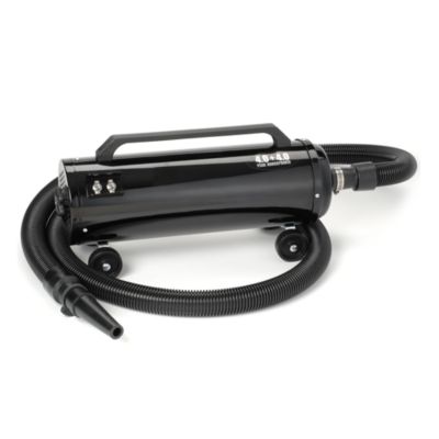

I bought a sidekick blaster and was testing it out the other day. I noticed that the body portion was not "sealed" completely. So when it is turned on, air will blow out of the nozzle and the non-sealed part. Just wondering if this is how it is supposed to be.
I had a similar problem with my Master Blaster. I ended up going to the hardware store and buying some plumber's rope caulk to replace what Metro had used and careful not to over tighten the cap. The caulk is a non-hardening soft material that basically seals the gaps between the cap and body. It works as long as you do not over tightened to expand the gaps beyond the caulk.
They all leak air. I wrote about this a while ago in a review of the Master Blaster and Sidekick. I got silicone and smeared it all around the leaks on my Sidekick. It stopped the leaks but looks pretty ugly. The Master Blaster is powerful enough - not worried about that.
I had an AirForce Blaster. It leaked as well.
It should say on the box that air coming out of the body is normal for the sidekick if I remember correctly. Mine does it and it works just fine.
Actually, once I sealed up the air leaks it seemed more powerful. Mine leaked air so bad it would blow other stuff down, like towels and such, that were near.
