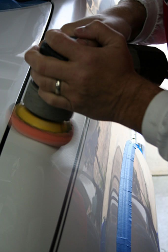

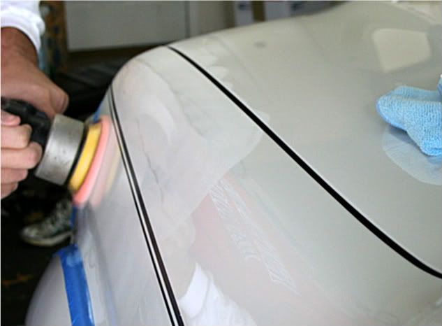

Ok, I had a chance to try this mix out. I mixed M105 with poli-seal 50/50 and Robbyboats and I attacked the hood of his 'new to him' white Toyota Tundra. The truck was heavily oxidized and I doubt it has ever been polished and probably rarely ever waxed. It looked like a piece of yellowish chalk.

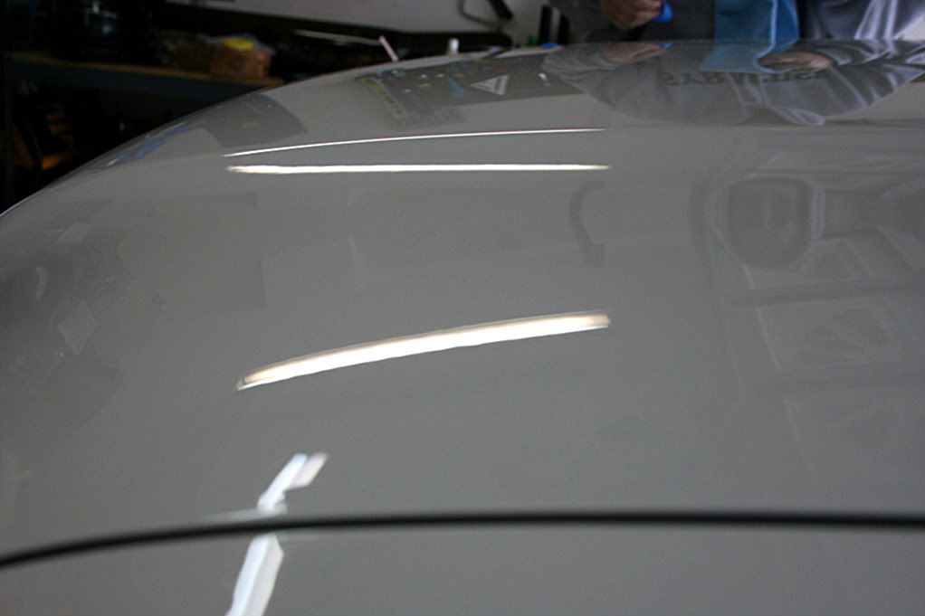

After claying, we did some passes using 4 inch white, 4 inch orange, and I think we even did a pass with a green pad. At first, we were both pretty stoked on the outcome. We easily cut right through all the oxidation and the gloss was immediately coming back and looking like it should. Under closer inspection under some good light, we could see that we probably only getting 50-60% correction. IME, we should be able to acheive about 80% correction with 1 pass using just 105 and an orange pad.

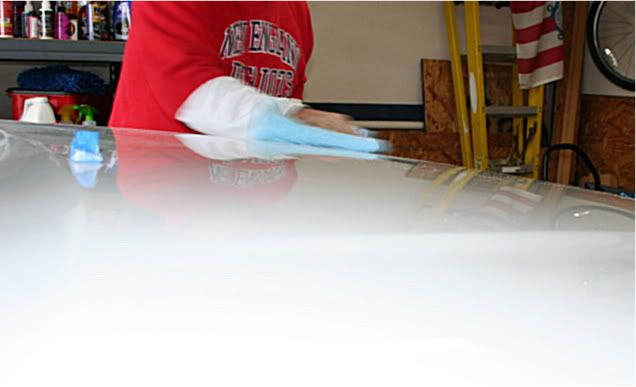

Moving on to the rest of the truck, Rob resorted back to JUST the traditional 105 and an orange pad. As expected, we saw 80-90% correction with just a few RIDS remaining. Following up with M205 and a white pad to gloss it up a bit more. An IPA wipe, a good close look then poli-seal using a green pad, 2 coats of opti-seal cured for 3-4 hours then touch up buff with OCW and a 530.

Mr Mike Phillips - You were right in this instance. The mixed product basically just turned into a decent working medium polish which I already have on the shelf and mixing these was really a waste of 2 products that are great all by themselves.

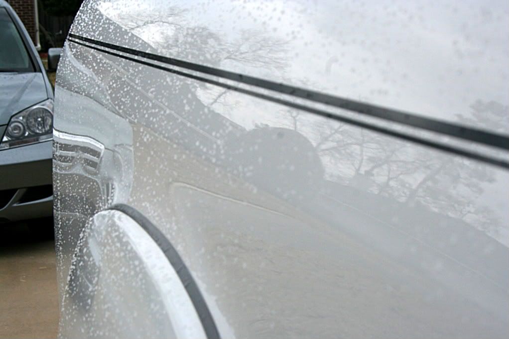

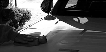

I did manage to snap a few pics but a bit off topic as this thread was originally aimed at mixing 105 and OPS. As I said, it did OK but we switched over to 105/205 and immediately saw this neglected paint coming back.
haven't touched the doors or roof yet...nasty

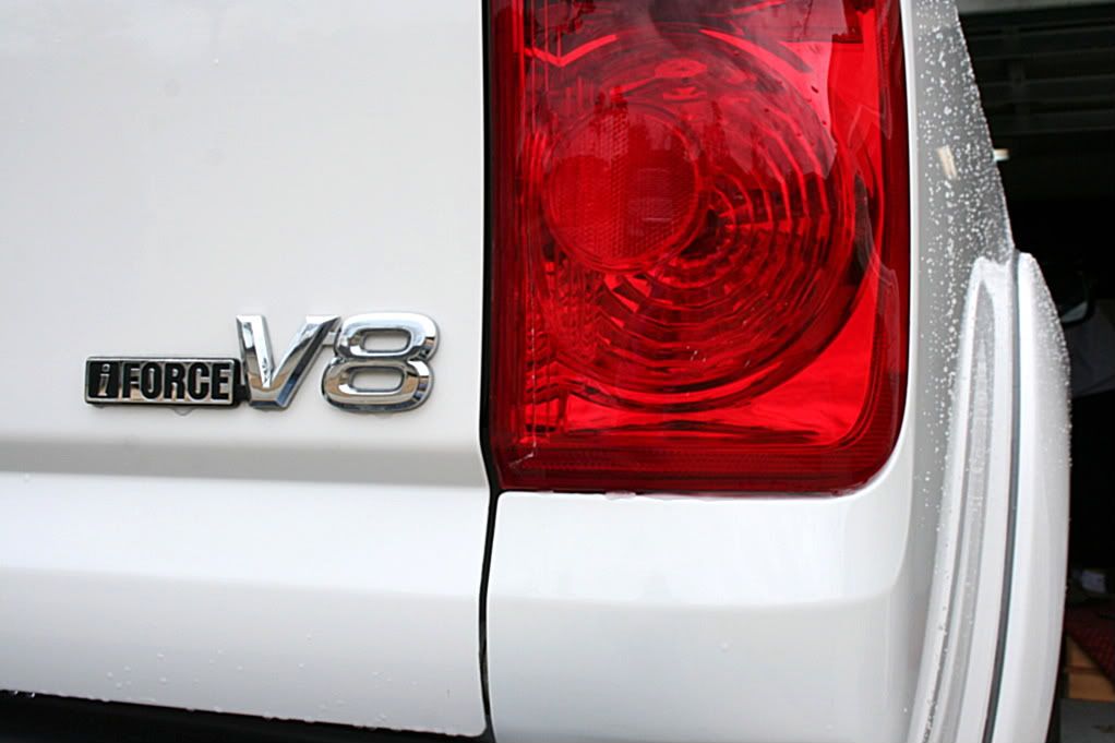

The rear quarters and tailgate was done the night before. Today we had the nose in the garage and got back to the hood and front quarters.
