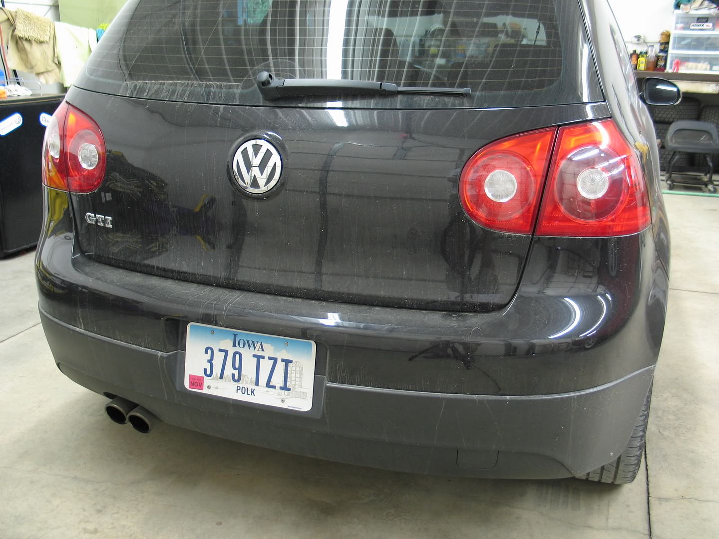

Car came to me with a few buffer ribbons from a previous owner/dealership that obviously didn't quite know what they were doing. Car cleaned up extremely well and I think I have a new favorite color

Befores: (I took some pictures with and without the flash to show different defects
Check out these nasty exhaust tips
Gotta love Foam Guns
This car had some nasty surface contaminants. Mostly just bugs, looked like someone put the passenger side front wheel thru some fresh paint and threw it all over the door/fender, some old decal/emblem glue, and in the rear some nasty brake/rotor dust. Today was the first time I used Meguiars Professional Clay (I used the mild version) and it worked FANTASTIC!!! All of the following pictures of the clay are from about a 3' by 3' section. I had to kneed the clay very often. The pictures will explain
An example of some of the buffer ribbons left behind. I think this is the only pic I have of them but they're randomly placed around the car. Nothing too serious and definitely something that can be fixed
