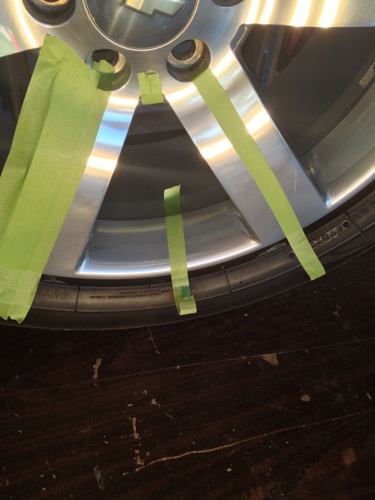

I also saw where Forest at Mother's recommends using a plastic polish with the cone on the wheels. I had a bottle of Megs PlasticX so I tested it against Megs ScratchX applied by hand.
Mothers Power Cone w/ PlasticX on left and Megs ScratchX by hand on right:
This is the same with the taped removed so you can see before and after on both sections:
I did 3 "section passes" with each product. I decided the Mother's Power Cone / PlasticX side looked better (Hard to see in pics I know) so I used that.

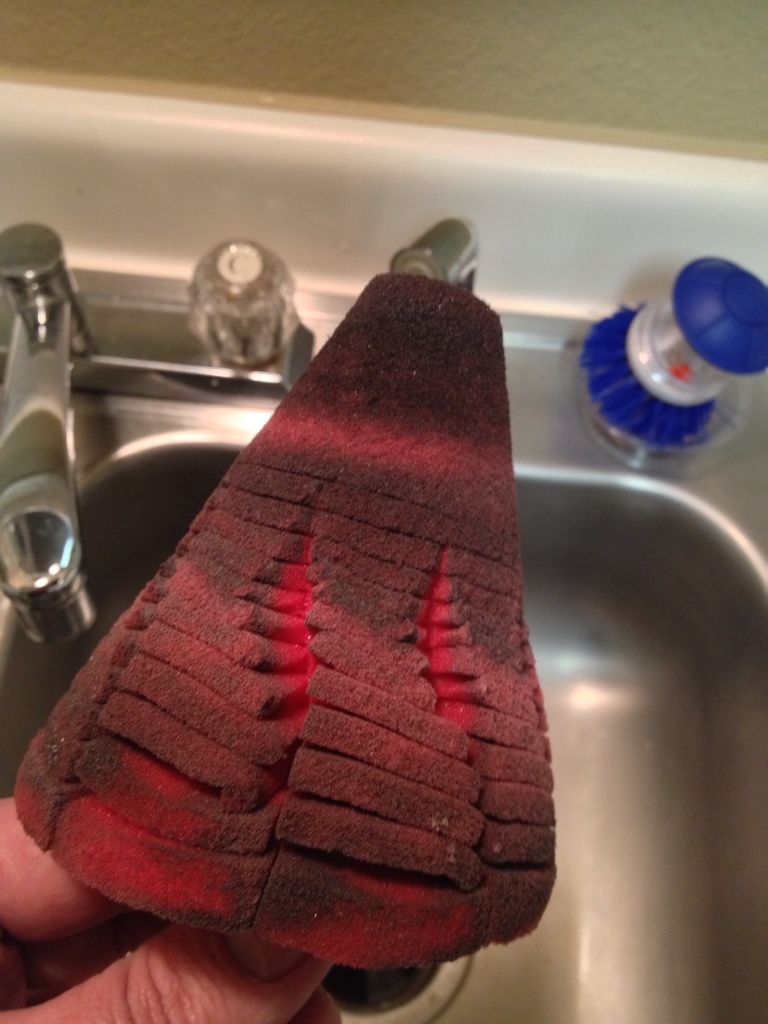

The cone was easy to use and it easily conformed to the corners where the "spokes" meet the "rim" and the "hub" of the wheel and got those tight areas well. It was also easy to turn on its side and do the wide "flat" parts of the spokes. It also pops into the lug nut "holes" well and it even removed some of the buildup that I couldn't get with a brush/rag and Simple green. (That's why it turned kinda black.)
This is what it looked like when I got done:
I cleaned it by spraying it with CG So Fast Pad Cleaner and Rejuvenator (diluted at 1 oz per 16 oz water as directed) and I let that sit for about an hour (got cleaned up and had dinner).
I then rinsed it with warm water and it got mostly clean, so I saturated it with the CG cleaner again, squeezed it a couple times to work the cleaner into it and on final rinse it got clean enough for me.
