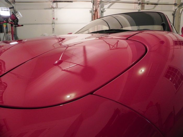

Don't have any pics handy so I snagged one off the interwebs, this is my car:
Somehow it seems it avoided buffer attacks in the year prior to my ownership (it's a 2000 and I bought it in 2001), so it's been basically just keeping it cleaned and maintained-and it's always garage kept and washed or at least Q'D after a drive. The dailies will be a challange, this one is all about keeping it as nice as it is.
This is an older pic with the stock rims but it shows the reflections better

nice looking car.....there are several 'systems' out there....and being new at this myself, I can tell you that it can make your head spin. Griots Garage new BOSS line seems to be fairly straight forward, and 3D products like HD Speed, HD Poxy, HD Adapt and that line-up generally get good reviews. Best of luck with your choices, as I'm sure many of those here that are legitimate professionals will chime in and help you.
