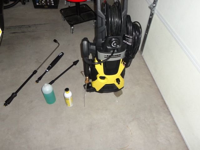

I picked up the Karcher K5.740 pressure washer (have I mentioned I love this thing:))
I was going to go with the Foam Cannon but the reveiws I've read about the MTM Hydro,I decided to go with the MTM.

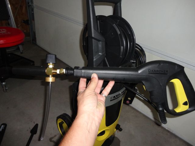

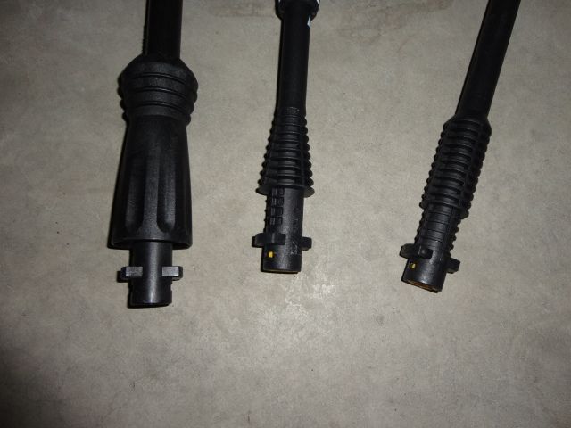

The only problem is that the Karcher doesn't just connect with the HydroFoamer because of its connection design:
If you pick up the karcher adaptor it will connect and mate the two:
As soon as the rain lets up here,it's time to go out and make some frothy foam with CG's HoneyDew car Shampoo:
Stay tuned for added foaming pictures............ :xyxthumbs:

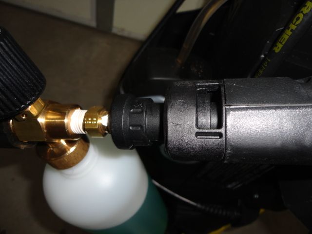

Well I was going to showcase some frothy foam for everyone because it stoped raining but I ran across this issue:
I took this o-ring:
and placed it on the end of the adaptor but there is no recess for the o-ring to sit.This area is radius'd but the o-ring will not stay in the recess on it's own:
So I kinda set the o-ring on the adaptor and carefully inserted the adaptor and o-ring into the Kartcher gun:
and I still got the leak?

This is exactly what I mentioned above when I said "don't freak out..." and is a pretty easy fix..
Your o ring just came dislodged in shipping.... So did mine....
Ok. Unscrew the black plastic Karcher adapter you got from AG.
Grab your o ring and set it aside for a second. Now tap your black plastic Karcher adapter onto a table or hard surface unil a small black plastic tube comes out. Remember to tap it FAT SIDE (side with threads) DOWN. Yes, there is a small plastic tube that lives in there. Now this part you just have to trust me, because it seemed wrong to me at first. That o ring actually goes in first, behind the black plastic tube. What happened is, it got dislodged in shipping and came out the other side of the adapter (gun side) so it LOOKS LIKE it sits between the adapter and the Karcher gun. But, actually it goes in the adapter from the other side ( thread
side). So to simplify it:
Take your dissasembled Karcher adapter (tube and o ring out) and CAREFULLY feed the o ring into the adapter through the top threaded side of the adapter. It doesn't sit in a "groove" it will kind of bottom out. Shine a flashlight in there and make sure it's centered and even
Now gently feed the tube in the adapter the same way (through the thread side of the adapter) it will just gently "sit" right on top of the o ring. There is no "click", but the tube is sort of a tight fit and it will hold the o ring in the correct spot. No force should be required. A set of picks or a tiny screw driver helps initially fit the o ring.
... Now... That's it! Re-assemble you adapter to your foam cannonon carefully. When you tighten it, this will put some pressure on the tube, slightly flaring the o ring and it will hold the whole thing in place.
This is a common problem with these adapters, but once it's set it's not a problem any more. Seems to only happen when everything is new before the o ring gets "pressed" by the little tube...

Hi guys, I'm in the same boat here with the Karcher. I've got the same Karcher pressure washer and an MTM foam lance. Got the adapter piece from AG but now my problem is the brass fitting that connects the two. It has a big end and a small end, but I need one where both ends are the smaller diameter... Did you guys encounter this? Just a trip to the hardware store or what? Thanks.
Brian A.
Having just gone thru this whole process of buying the wrong fittings and then finally getting the right ones, I can confirm that you need the following fittings for the Karcher K5.740 to work in conjunction with the MTM Hydro Foam Lance:
1 PW-KARCHHD - Karcher HD/HDS Pressure Washer Fitting
1 PW-KXSERIES - Karcher X Series Pressure Washer Fitting
I have attached some photos of how these pieces should fit together. Now everything fits perfectly.
