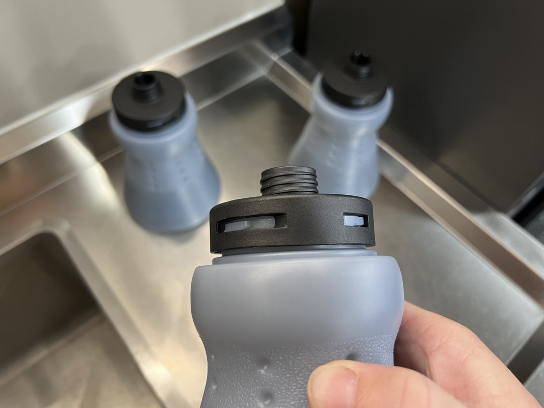

MTM knew they had to respond to the onslaught of newer competition sporting wide mouth bottles. With the latest update to the PF22.2, MTM have redesigned the bottle to have a wide mouth and a bayonet fitting. Retooling for a new foam cannon body would have been very expensive, so MTM designed a plastic adaptor to mate the old brass body to the new bottle. Some have complained that this is a half-assed approach but take a look at the competition……………they are doing the same thing. My only concern would be the durability of the bayonet fitting.

The black plastic adaptor is screwed onto the existing foam cannon body, nipping it up using firm pressure. I have seen the video where an additional rubber o-ring was fitted here to provide added threads for a tighter fit, but I really don't see the need. The adaptor is slotted to accept the tabs molded into the new bottle, which is then secured with an audible click.
The adaptor also has a rubber o-ring to provide a leak proof seal.

Now, I have seen video's of the new setup where the user was complaining about the bayonet fitting, in particular unscrewing the foam cannon body from the adaptor by accident instead of unlocking the bottle. All I can say to that is they are doing it wrong. If you hold the black plastic adaptor and not the foam cannon body when turning, the bottle is easily attached and removed.

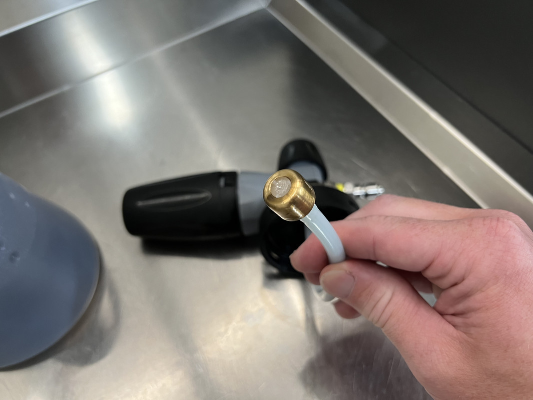

From what I can see, if you order the complete foam cannon, MTM now include a weighted pickup tube. This addition helps maintain foaming when the bottle is low on solution and used at certain angles. However, this was not sent with my retrofit kits. I actually had a spare Kwazar weighted filter on hand and attached it to the existing tube, which worked very well. For US customers, I see MTM Veloci now sell the weighted filter separately, along with additional bottles.
