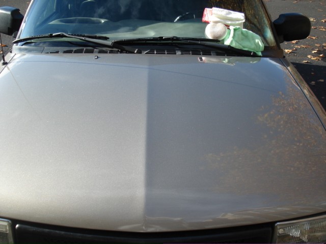

before and after of hood
View attachment 20700View attachment 20701
