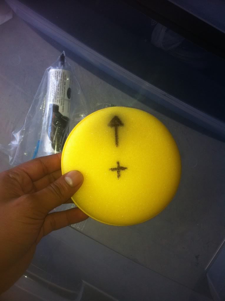

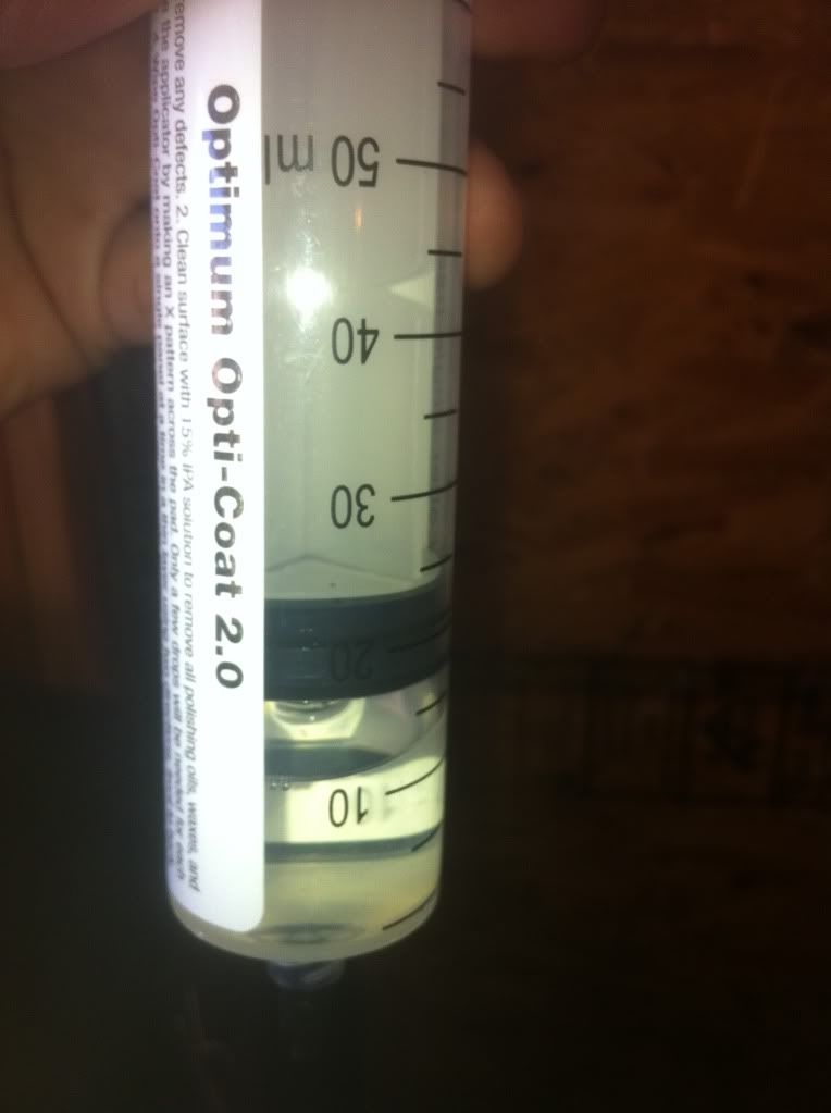

^ I still have this much left and I applied 2 thorough coats I believe
I also marked the back of the pad and I only applied product in the area to save product.
Seems like I did a good job for my first time and with only AGO Members to help me out..., thanks guys btw :)
