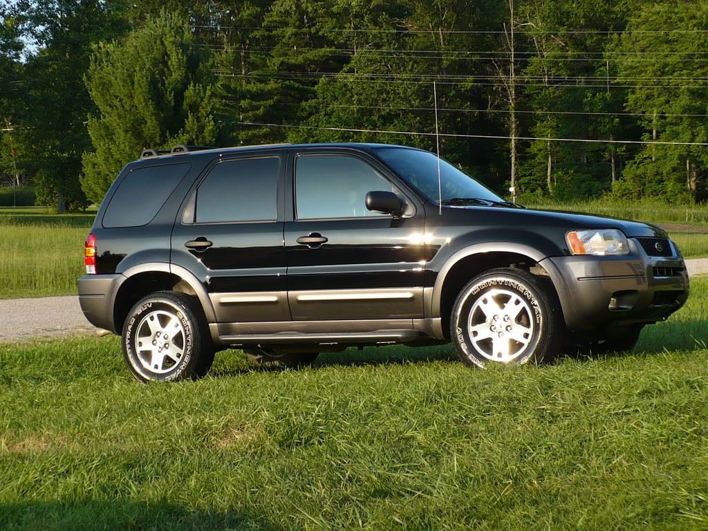

Well, after doing a few cars, I finally feel comfortable enough to post up here for you guys to see my results. This is a 2003 Ford Escape, 50,000 miles! This looked worse then the 2003 Bonneville I bought last year with 125,000 miles on it.
I tried SIP with an LC CCS orange pad and it just didn't cut it. I didn't have anything else, and I didn't have the time to order something online and wait for shipping. SO, I picked up some Meguiar's #4 locally. I know, I know, probably not good stuff, but it was all they had.
Two bucket wash with Meg's Gold Class car wash and grout sponge
Mothers clay bar
Meg's #4 with orange Wolfgang & UDM
SIP with LC CCS orange pad & UDM
Menzerna Micro Polish with LC CCS white pad & UDM
IPA wipedown
Meg's # 21 V 2.0 with LC CCS black pad, removed with LC CCS blue pad
Wheels and tires
cleaned with DP gel wheel cleaner
Meg's Gold Class Endurance tire shine
rims got treated with Meg's #21
Here it is, please let me know what you think. I know that the wheel wells could use more work, but that is the best I could get them without an APC.
BEFORE (sorry, I didn't get a full vehicle before shot )
Now AFTER!!!

Well I would say you have nothing to be worried about, great First Show N Shine and hope its not your last. Amazing results! You should be VERY pleased with the results!:righton:
Thats one crazy shine, makes me want to polish my old civic ('97 black). Got some old maguire's products that i need to use up while waiting on my order from AG :D
This is just one of the pics that convinced me to order more AG products :P
Hey, looks really nice my girlfriend thought it was 2 diffrante cars lol, you should try spraying WD-40 in the wheel wells, which will keep the wheel wells looking black for about a week, also helps prevent rust, i do it on my car n people who are close to me havent dared to do it for a custumer yet but I learned that in a detailing shop :)
I thought that was a scratch down the side, but it's the reflection from other cars in the background. I am jealous! VERY nice work!!! :righton:
I almost didn't post that picture for that reason LOL. Even after spending all that time on it, when I looked at the pics, I freaked out thinking there was a huge scratch! It took me a few moments to really look at it and see what it was:D
Great turnaround there! I can see why the owners were so happy. A good product to return that new black look to wheel wells is Megs All Season Dressing. Again kudos for using a black car for your first show and shine!
I have to say that so far, black is my favorite color to work on!
