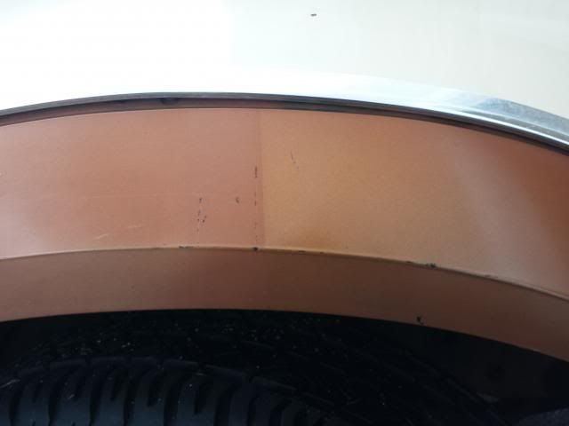

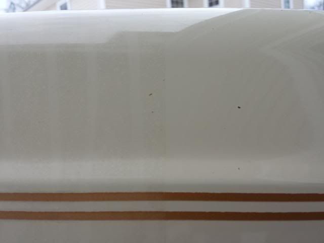

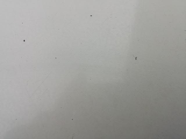

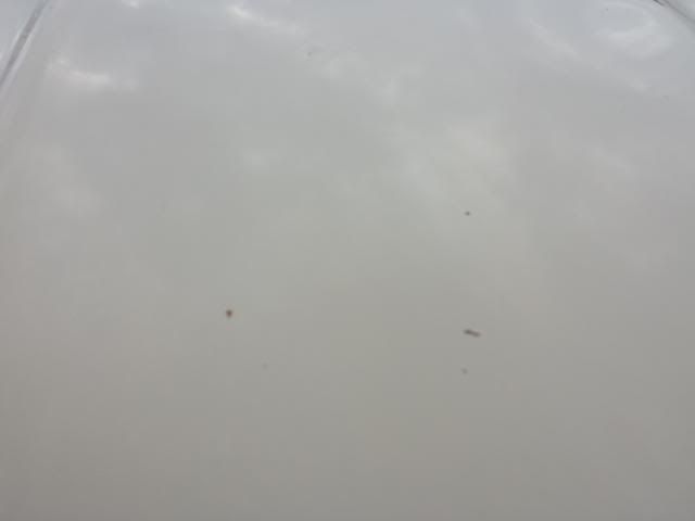

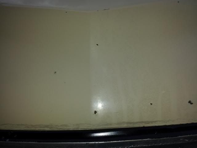

1984 AMC Eagle. It has a single stage Almond Beige original paint job that has definitely seen better days.
It is his winter beater, so he didn't care to do a full correction on the whole car, but he did give me free reign to play with a few spots and learn about Single stage paint.
I only did 4 spots after he washed it, and didn't spend a whole lot of time doing it, as he got bored.
I used the following products.
-Nanoskin green apple Bubble Bath
-Nanoskin microfiber towels
-Nanoskin autoscrub 7" towel
-Nanoskin Glide lube
-Nanoskin Formula 67 polish
-Nanoskin Microbuff yellow pads
-Nanoskin Microbuff black pads
-Nanoskin Microbuff blue pads
-Nanoskin Speed Cut compound
-Nanoskin Nanoceramic sealant
-Meguire's Water Magnet waffle weave drying towel
-Porter Cable 7424XP
-Grit Guard's for 2 bucket method
-Autozone microfiber wash mitt
-Citrus degreaser
-Mothers Mag and Aluminum polish.
It was filthy when he showed up, lots of grease everywhere from him touching it while replacing the transmission, so first thing I did was to spray a very diluted citrus degreaser on some of the bad spots.
After I sprayed it with degreaser, He rinsed the whole car, then used Nanoskin Green Apple Bubble Bath and 2 bucket method and grit guards, then dried it with a Meguires Water Magnet.
I then decontaminated the areas with a 7" Nanoskin Autoscrub Handy Towel and Nanoskin Glide.
Once that was done, I used a NSMB(NanoSkin MicroBuff) 5" black pad and Speed Cut to get rid of most of the deep scratches in the paint.
Correction Step 2 was done using a NSMB Yellow pad and Formula 67.
I finished it off with Nanoskin Nanoceramic sealant using a NSMB blue pad.

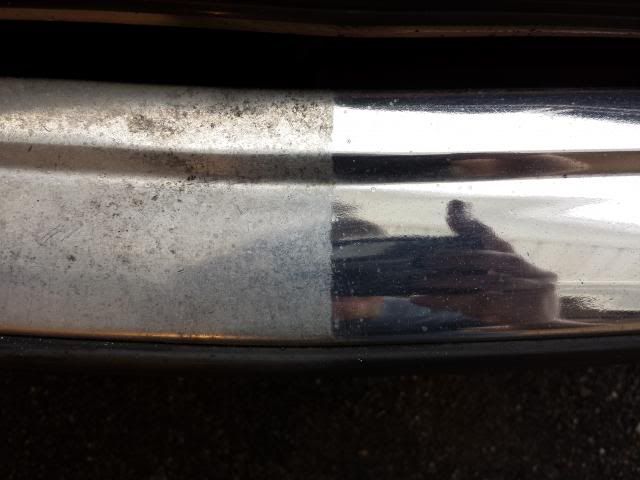

I cleaned up the front bumper using Mothers Mag and aluminum polish and a MF applicator pad and elbow grease.

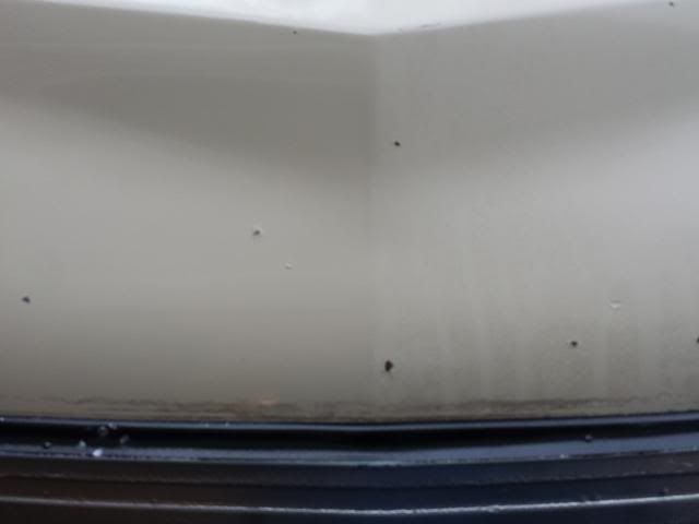

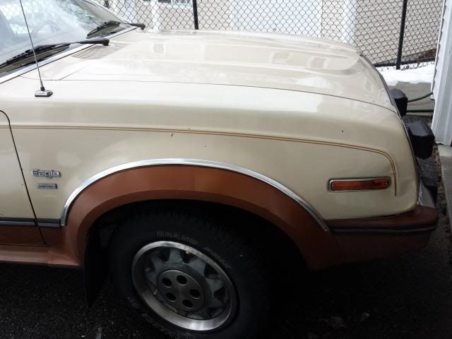

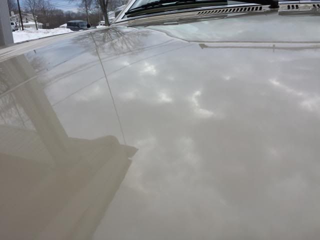

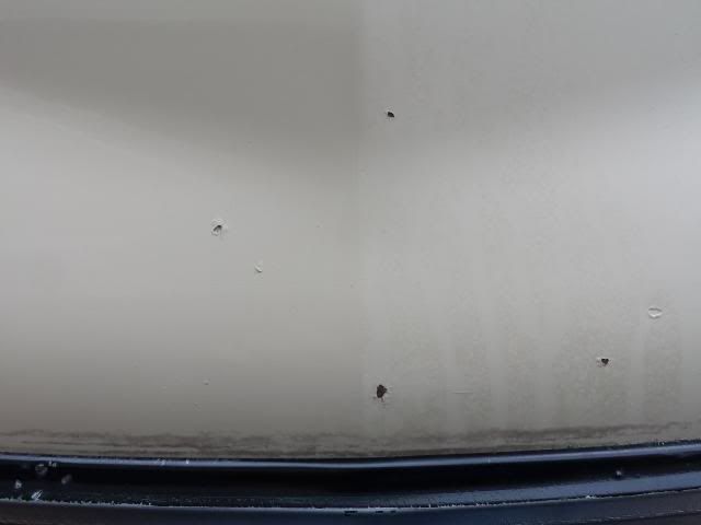

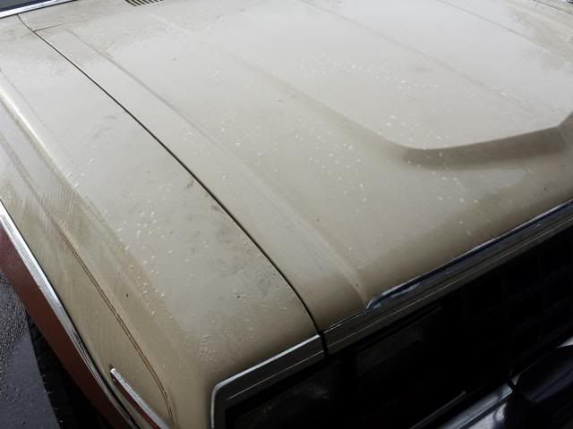

Here are the pictures.
Before
After
50/50's
He was very happy, but didn't have the desire or time for me to do the whole car, but it was a lot of fun doing the 50/50's and seeing the difference I was able to make on the spots that I did do. I know it isn't perfect, but I am still learning, and this was only my 2nd time using a Machine polisher.
Enjoy!
