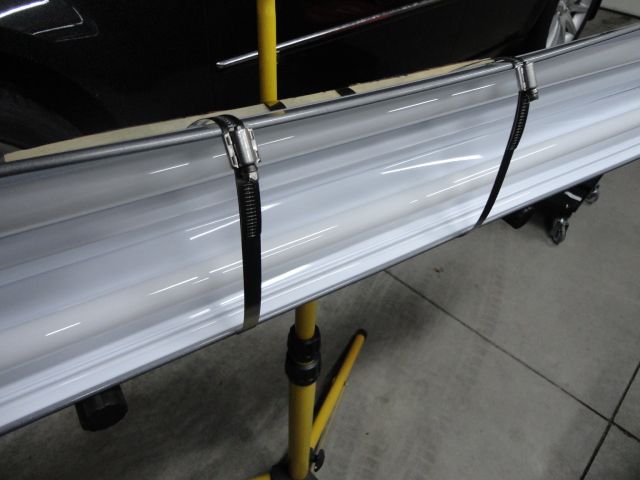

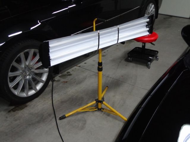

I decided to run up to the local hardware store and pick up some item's to make my own version.
I already had a base I wasn't using that had a perfect (for me) base for me to put together my idea.
With a few band clamps it came together just as I had planned.I also used a 2x4 piece of wood for back support:
The band clamps were trimmed after these photo's were shot,but it show's the idea:

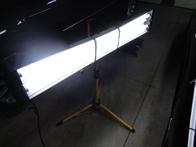

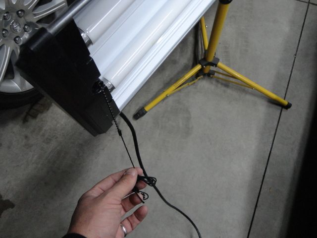

I put the bulbs in and pulled the on/off string to see if it would work:
WaaLaa:

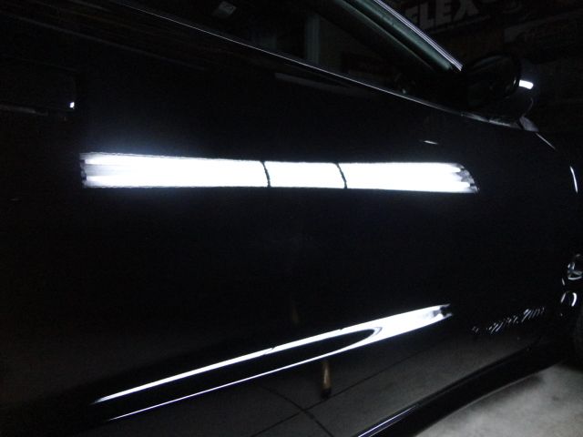

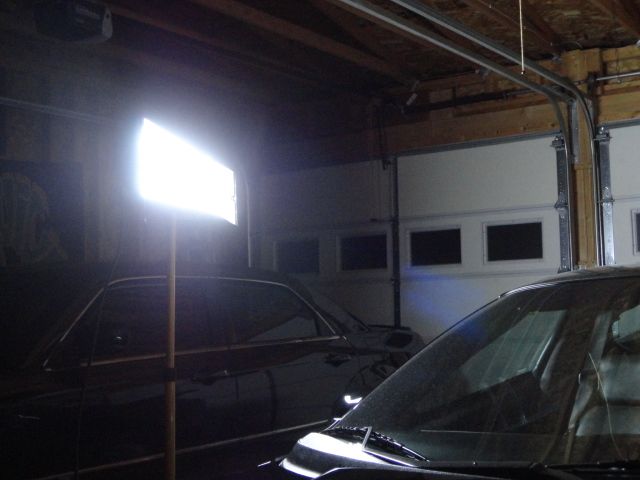

I shut off all the other shop lights to see how it would illuminate the side/horizontal vehicle panel's:
closer:

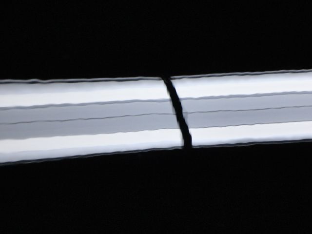

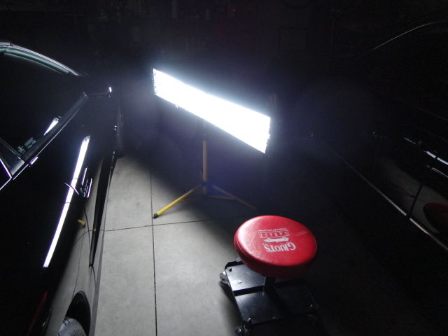

and up close and very personal:

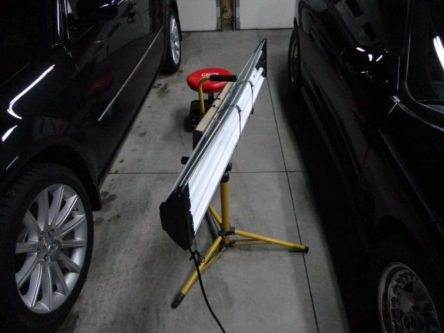

this creation works like a charm:
and BTW,I still have function of over 6' of telescoping useability:
Hey,I never said it was pretty but for less than a $50 bill,I have exactly what I was looking for on a portable horizontal light source and under a 1/2hr to do so. :props:
