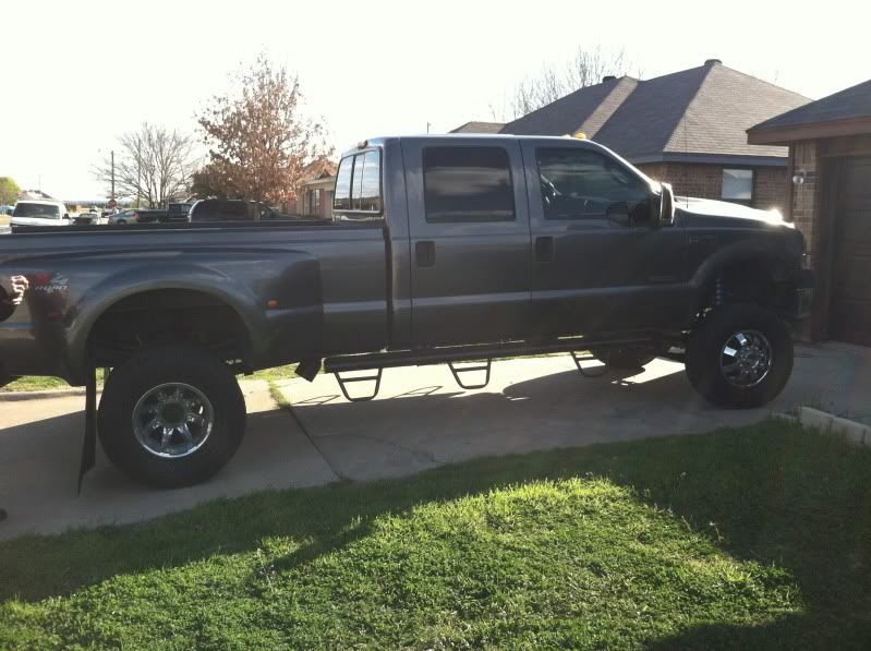

Well, I decided to ship my detailing stuff down so I could tackle his lifted F350. I forgot my camera so I took some pics with my Iphone.

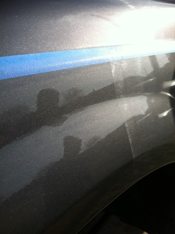

I had just got the Meg's MF system and I can say that I was amazed at how well it worked. I did a few sections to test out the different MF pads and the D300. The MF cutting disk and D300 did a great job and probably got rid of 90% of the swirls and to my surprise finished LSP ready.
Here's a 50/50

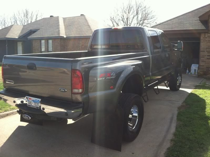

And a few finished pics. All in all took the two of us around 8 hours to full detail the truck doing a 1 step polish and topping it with blackfire wet diamond.

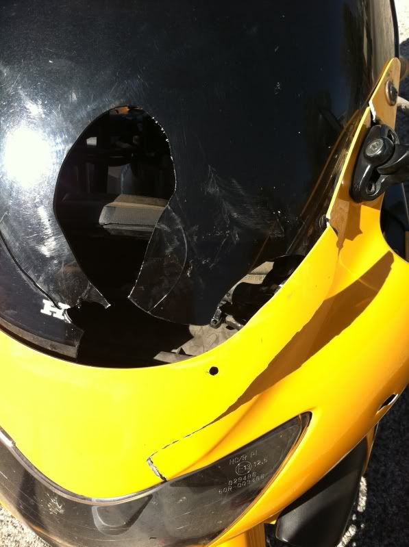

On a side note my brother attempted to teach me how to ride his now wife's motorcycle...let's just say it was an adventure. I ended up hitting his old beater truck he had parked in the street. I was only going about 5 mph so I didn't get hurt. But caused some damage to the bike...

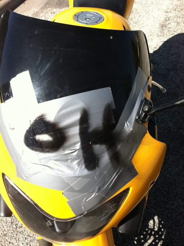

Nothing a little duct tape and spray paint couldn't fix. I should note that this bike was already beat up pretty good. I told him I'll give him the money for it when he decides to get it fixed.
This was when I initially took off on the bike...my own fault for not using the clutch...after this incident I ended up popping over a curb and drove through someone's yard before I got the hang of it. After that I was fine riding up and down the street and turning. Just took me a little longer than I expected. Needless to say I didn't go out on the roads! Thought this was a funny story though that I'd share. I'm sure most of you who ride bikes will get a good kick out of it!

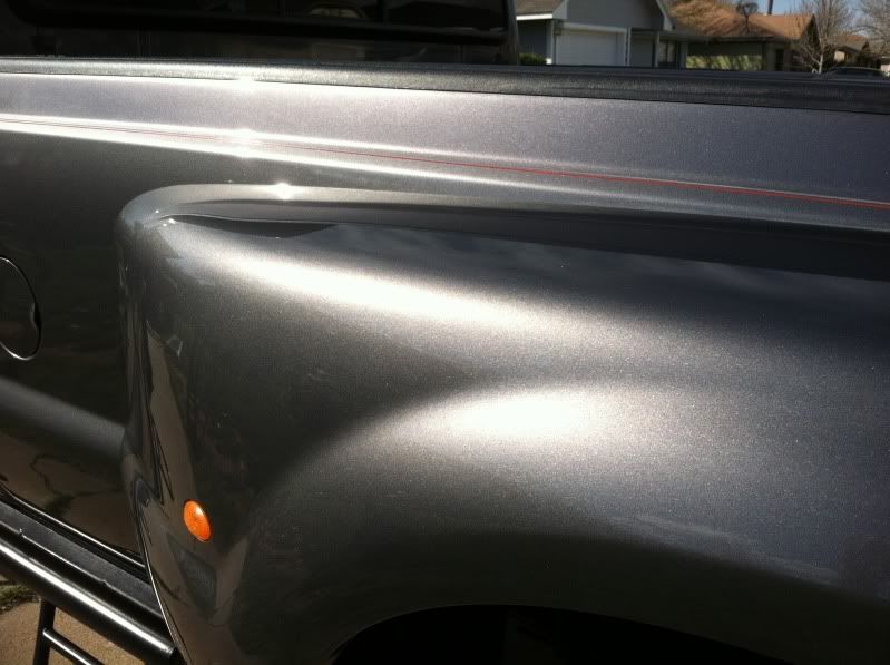

How did you work around the red pin stripping?
Im going to be doing my brothers lancer soon and he has the same thing. Curious what you did.
I taped it up. Polished the whole truck then removed the tape and did a light polish on the stripes with my DA. They were painted on so they were more resilient than vinyl stripes.
