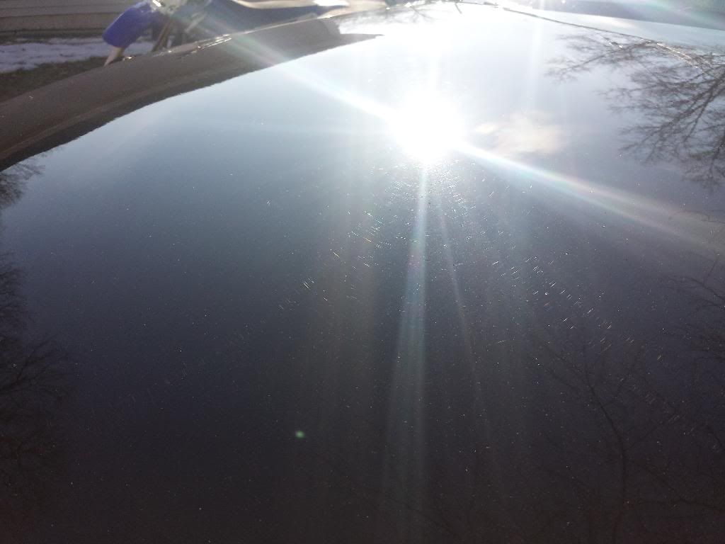

The cut with the black/ cutting pad is GREAT. I had some very major scratches in the paint on my hood scoop, and using the black pad/ speed cut, the scratches are almost gone, some are all the way into the paint, so I didn’t expect them to be gone. The finish after that combo was slightly hazy, but still shiny.
The yellow/ polishing pads were great with the Formula 67/ speed cut to remove the swirls out of my Subaru’s paint/ and on my buddy’s 85 AMC Eagle. They came out with a very high gloss, and ready for sealant.
