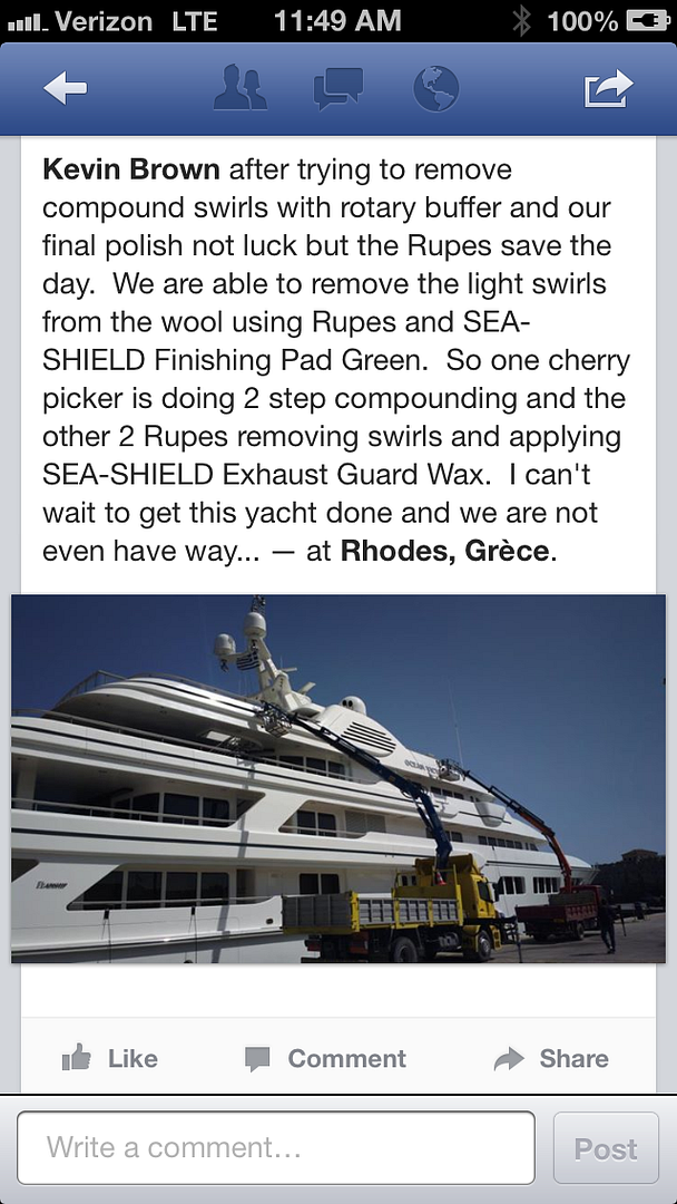

The Rupes wouldn't be bad though, and I actually recall seeing someone post on FB a MASSIVE, I mean MASSIVE yacht that they did with a team of guys and Rupes LHR21's! He loved them!
Hopefully this person doesn't mind me sharing this. :)
