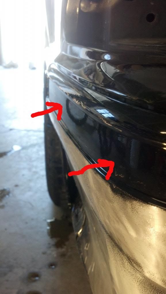

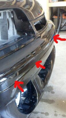

Instead of starting a new thread I figure I'll just keep all my questions in here. So I'm just about done wet sanding the hole car to get rid of all the orange peel but I've got a few spots left I'm not sure what approach to take. Need some help from the pro's. I have a body molding that goes around the hole exterior of the car. Within this molding there is a strip about 1" wide and is inset about 1/8" of an inch. I don't dare touch this area with sand paper cuz I have no idea how I would go about buffing it. But I would like to get the orange peel out of there. Any ideas. pics included. Thanks
personally I wouldn't touch the trim piece, I didn't touch my trim pieces, and to be honest I sanded and buffed the car before they were put back on to make it much easier
