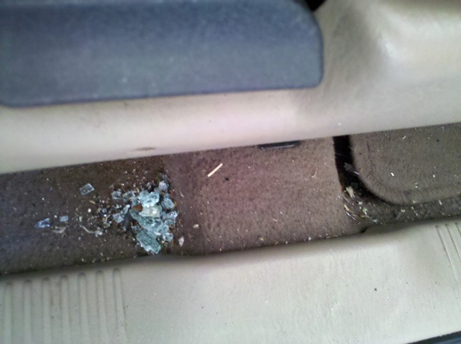

Do you think the same product will work on scratches like these? Thanks.
