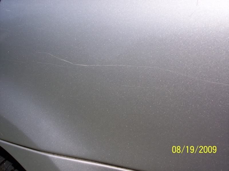

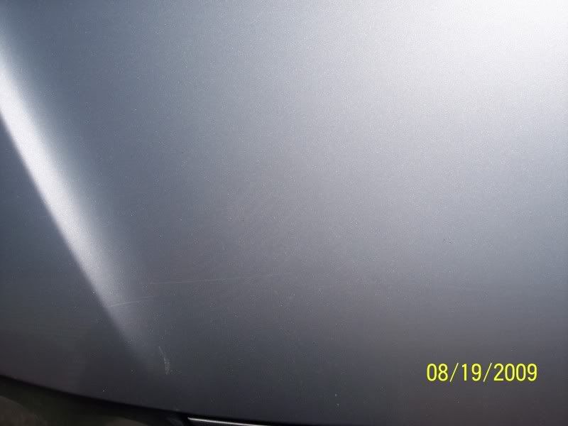

Ok got some pics. First one is off my hood were you can kinda see the swirl marks I was talking about. You can see it to the bottom left, look real close.
And heres the key mark (theres more but there all same)
Need help on what will remove swirls and help with the key marks:(
Remember, always use the least aggressive method first. Meguires M205 is moderate and will clear up your swirl marks quickly and efficiently and give you a nice polish. Try a few passes with this and evaluate if you want to go more agressive on the scratches.
The key marks look fairly deep. Megs 105 is a compound that will definitely help with the scratches. Be sure to follow up the area with M205 to brighten it up after M105.
However, since you are just beginning, you may decide that you can live with some scratches for now, and practice on some scrap panels from your local auto body shop until you are more comfortable working on your on ri
Look forward to seeing your finished product :buffing:
I'll be posting my results from touching up a very similar, probably deeper, scratch from getting keyed later today/tonight. I hope I get the results that am expecting. If so I'll have some input for you. We'll see. :cheers:
Please do since I will not be doing the wax till next week probably
Thanks for posting the link! Great job! I think since I am still new to it I may just give the car a good wax and deal with the scartches when I learn more or get some help from someone who knows what there doing and can teach me. So any NJ guys out there or close who has some skills and like to teach let me know!!!
