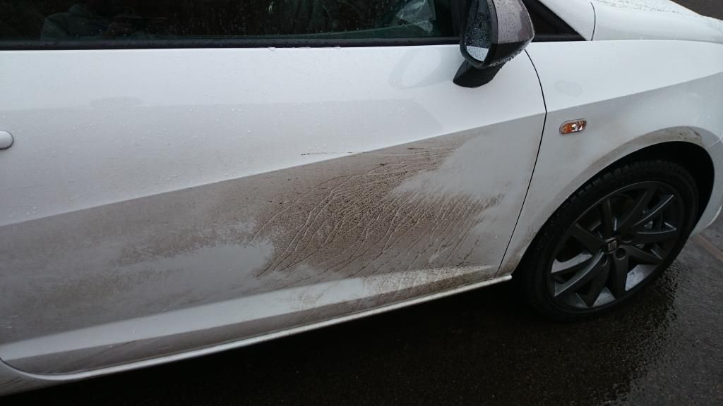

Considering the car had 5 miles on the clock when i got it, Mud, grit, tar spots, brake dust absolutely plagued the car, when I first seen it i really did have second thoughts about wanting the dealership to clean it for me! haha
I started by pressure washing the worst of it off and cleaning the alloys first, I used some autoglym acid free wheel cleaner for this along with a couple of boars hair brushes, wheel woolly and a long handled wheel brush that i bought from halfords for the arches, handy brush for 7 quid!

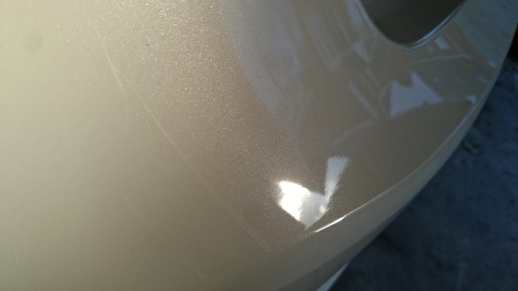

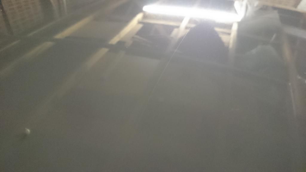

Once inside, i noticed that there were 1-2 large scratches about 6-8 inches in length on the bonnet, the roof, and front quarters, what the hell has been going on here?!
Did they drive the car through a load of overhanging branches just for the fun of it ??
Anyway, after a quick coffee I turned to my Meguiars G220, some M101 and of a microfibre cutting pad, I carried out a quick test spot on the roof and after about 8 passes the defect had gone, with my method working a treat i cracked on and took all 7 scratches out in about an hour.
At this point i took the chance to give the entire car a look over to see if i could see any lighter scratches or swirls, but everything was looking good

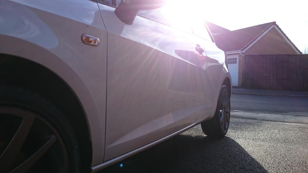

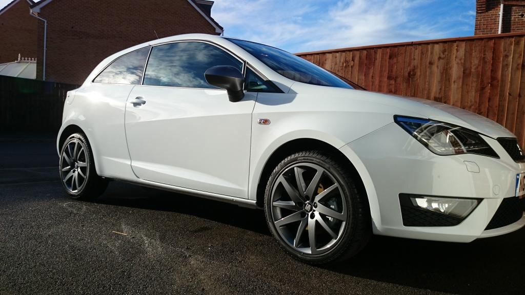

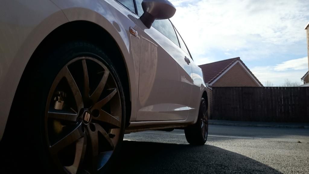

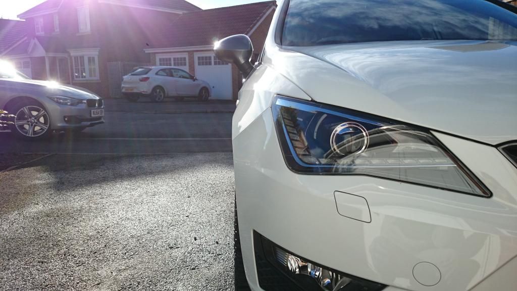

Finally, i applied some M21 with G220 equipped with a freshly primed black finishing pad, for all the smaller sections of the car and alloys, i used multiple foam applicator pads, waited 20 mins, performed a successful swipe test to each panel and buffed with some brand new meguiars microfibre towels and my god, were the results amazing, the photos speak for themselves!
