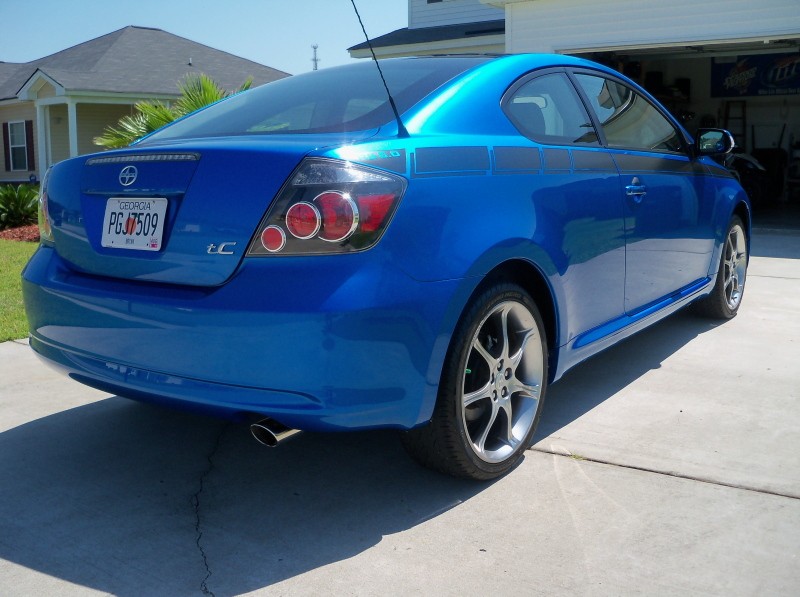

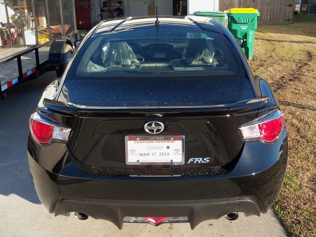

For detailing practice I have a test panel that I repaint time and again for practice. Normally, I paint it black, but I wanted to practice spraying silver in case I ever had to do a repair on my own car, so I painted it silver. When I went to clear it, my air compressor had died, so I never got to spray my 2K or 2-Pack clear. That said, I had several random 1K cans of U-POL clear, so I figured I would clear it with many coats of that then practice my wet sanding to remove orange-peal etc.
I finished, and the panel looked like liquid glass only silver.
Then the kids happened to take some dry erase markers and draw all over the test panel and the car, too. The car had completely factory 2-stage PPG paint.
Long story short, if dry erase marker wipes off, you have 2-stage, chemically hardened paint, so here is the test:
It wipes off at least 20 times better than most dry erase boards. Don't know why dry erase board manufacturers don't just clear coat them with automotive paint!
Here is the rub... on Single-Stage or really any 1K type paint, the dry erase mark will not wipe off. It takes the same effort to remove as a water mark that has etched itself into the paint!
