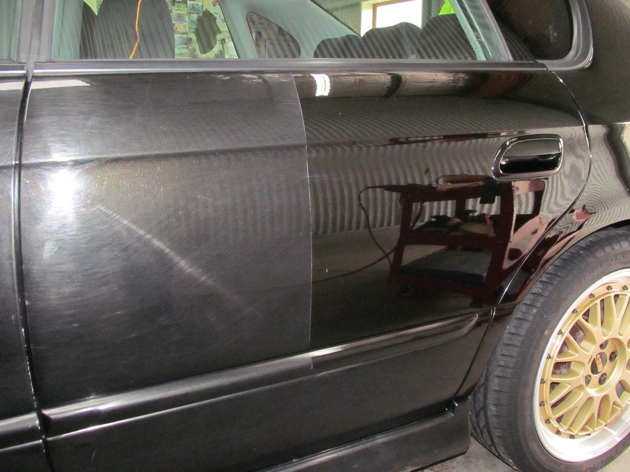

To the OP - I recently tackled my first polishing project. The car was black and the paint was soft so I had to go back to the drawing board a couple times to refine my technique. Its definitely possible to achieve amazing results DIY. My biggest take away from it was that the pads and polish you use are a function of your vehicles paint condition and clear coat hardness. Until you know those things, its hard to know what combination of products to use. For this reason, I ended up ordering an array of different pads and polishes to determine the least aggressive recipe to achieve the results I was after.
