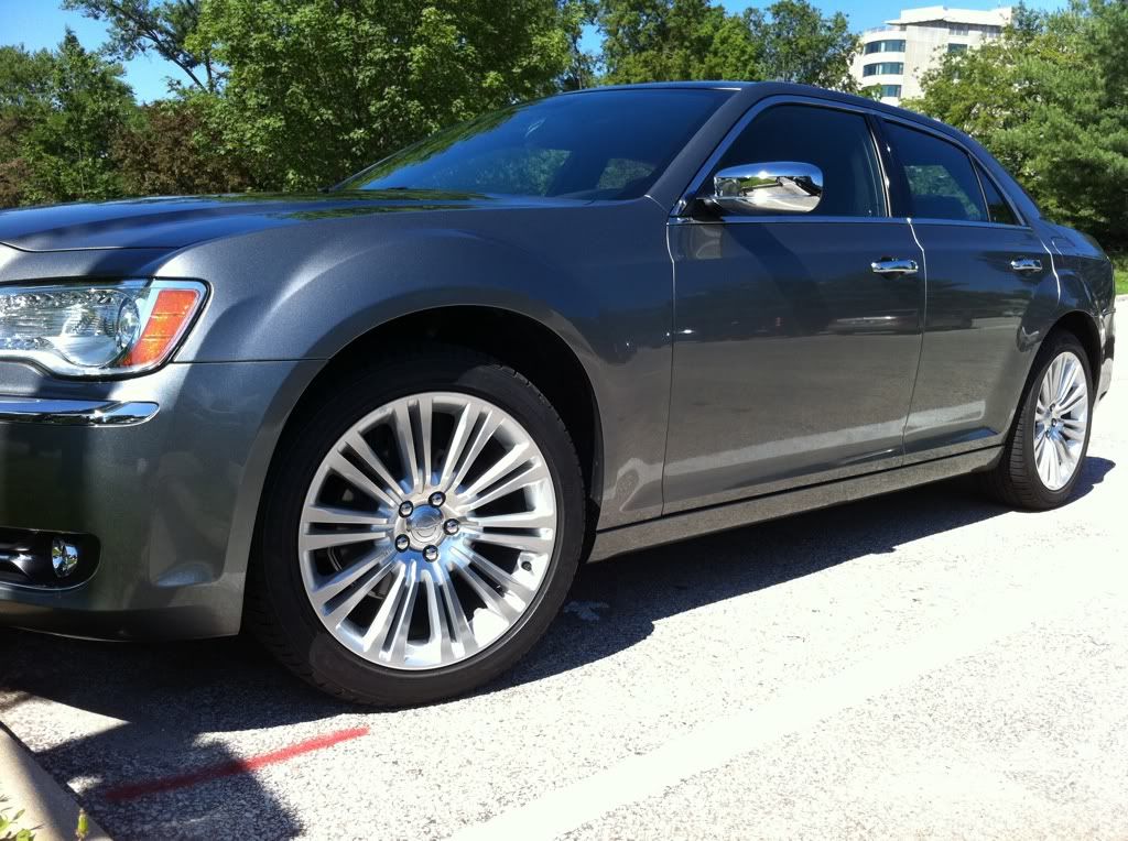

Today I put a coat of Meguiar's Ultimate Liquid Wax. Really pleased with the results. The car sparkles and I fortunately did not experience any streaking as others have reported. (including a quick pic).
There is a fair amount of chrome on the car - the side mirrors, the grille, door handles and other accents. I wasn't sure if it was okay to wax over this chrome so I did my best to avoid it. Can I/Should I apply the wax to the chrome accents? Is there a better product I should use instead? This chrome is a pain to keep clean!
As you can see from the picture I need some tire dressing. The wheels are polished aluminum (not sure if they have a clear coat on them). It sounds like Sonax is a safe bet for a wheel cleaner and the Daytona Speedmaster Wheel Brush is a useful tool. So, I plan on ordering those. Today I will pick up an OTC Megs tire dressing gel. Any other wheel/tire product you like for polished aluminum?

The surfaces you mentioned are not "real" chrome. I'd not use our Chrome Polish - I'd go with a wax - synthetic or carnauba - for protection.

How can you tell this by looking at a picture? I'm not questioning your knowledge, just trying to learn something.
And I would stay away from any cleaner/waxes.
Real chrome on metal parts may be hard enough to survive a cleaner/wax but the chrome finish on a plastic part won't. Just rubbing the skin on you hand over a plastic chromed part can be enough to scratch it.

If the parts are chrome plastic then I agree with Forrest, no harm intended but I was posting fast and furious while working on another project and just scanned the topic of the thread and posted my answer based upon my experience with real or normal chrome.
If it is plastic chrome, just keep it clean and anytime you're waxing the paint just buzz over the chrome too...

Thanks all! I have this question as well. The grille is clearly a chrome plastic but I am surprised the mirrors and some of the other accents are as well Truth be told I ended up trying it before I saw the post. I did a small section first and it worked great. The chrome looks amazing all around now - a real mirror finish. So, I am glad it did not damage it but it sounds like in the future it will be just wax for me.

"Real" chrome plating is done over a metal - Steel, aluminum, etc.
What are your mirror housings made of?
Most non-wheel "chrome" today is a vacuum film over plastic or a composite.

Good to know! It looks like it is a plastic - definitely not metal.
