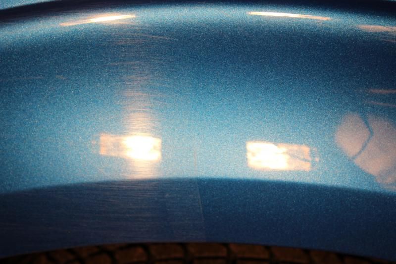

Owner called me to tell me that his son had taken his F150 off roading and that he "scratched" up the sides. I think there was more scratches than non scratched areas lol, you'll see what I mean from the photos.
Machine
Flex 3401
Compounding
M101
Tuff Buff black wool
Polishing
LC White CCS pad
Menz 4000
LSP
Collinite 845
Doesn't look that horrible in the sun right??

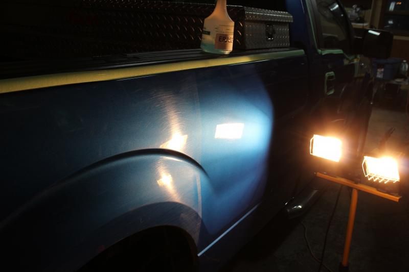

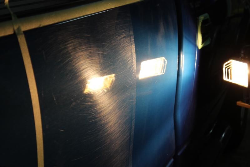

Well here it is under halogen work lights.. Overall it corrected nicely, required multiple passes and with the humid weather we had it made it even longer working smaller sections at a time.
My favourite pic.
