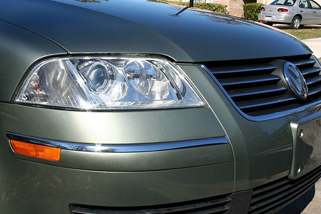

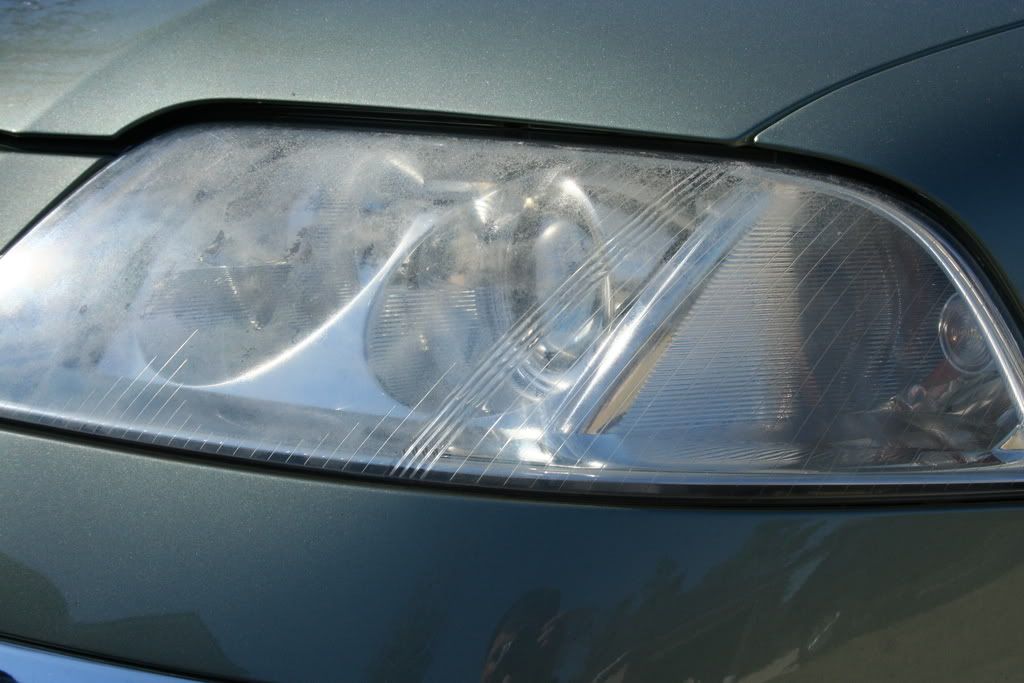

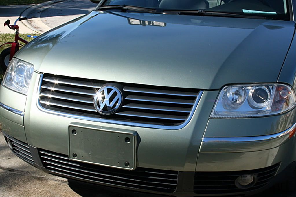

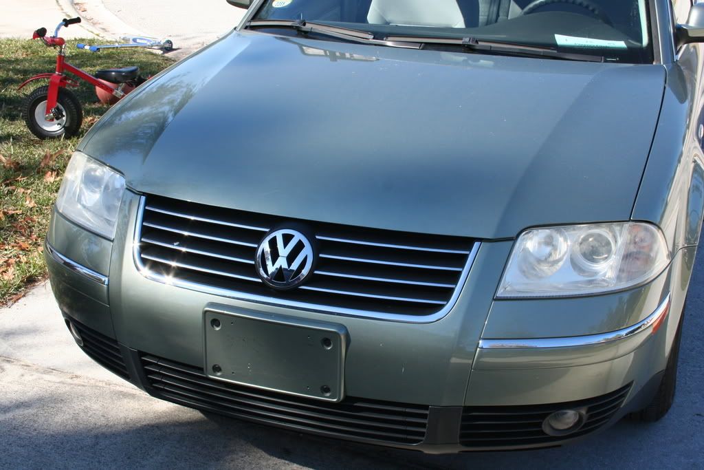

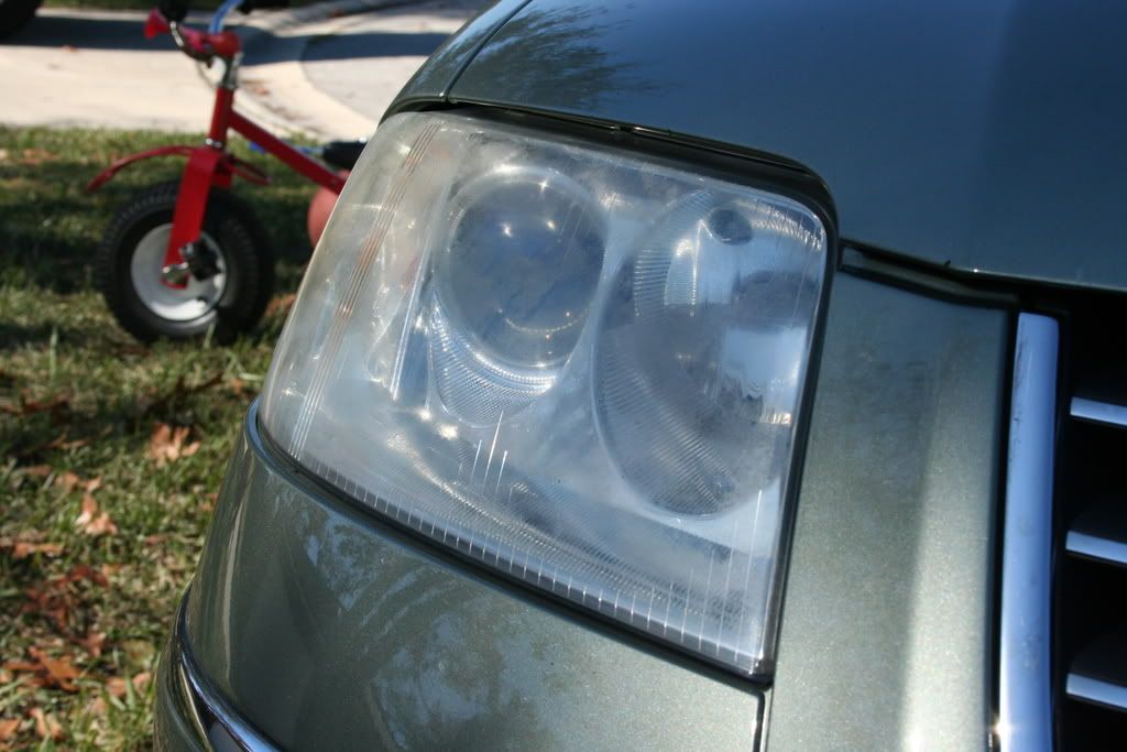

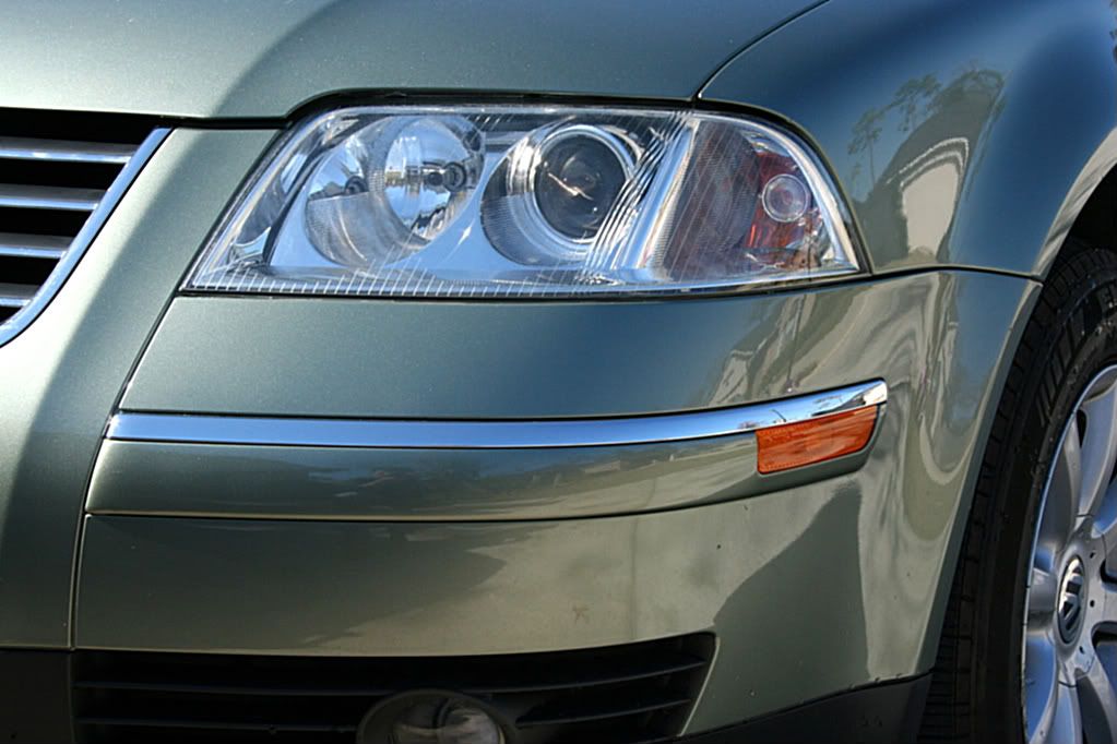

PC-4 inch orange pads hit first with M105 then M83, then PlastX. I could still see some pits in it but I've never done any wetsanding or anything but not bad at all considering. He was stoked for the 20 minutes I put into it. Since the Meguiars was throwing so much dust, I ONR'd the hood, fenders and bumper a little for him.

Wow...great turnaround man. That salesman doesn't know his a** from a hole in the ground. "That's normal." That made me lol.
OMG!!! That's incredible! I didn't know that that could be done. Wow!
fuzzy-It was kind of a guessing game for me too. I'm no pro detailer. I wasn't aiming for perfection, but I figured I could make it look a little better.
and yeah Josh...typical car sales banter "ehhh nothing you can do about that". pfft
Wow that 20 minutes was about the best it could have possibly been. The headlights stand out most too me(of course, not downing your other work which is great as well). I guess a dealer is out for one thing...money. If it were normal for headlights to be like that, then i guess the one on the showroom floor has it too hahah. Its then new sporty look
Those lights turned out really good. Now that you have them all polished and looking good, you should suggest having paint protection film applied. That will prevent the headlights from getting back to that point. A clean car is a happy car.
