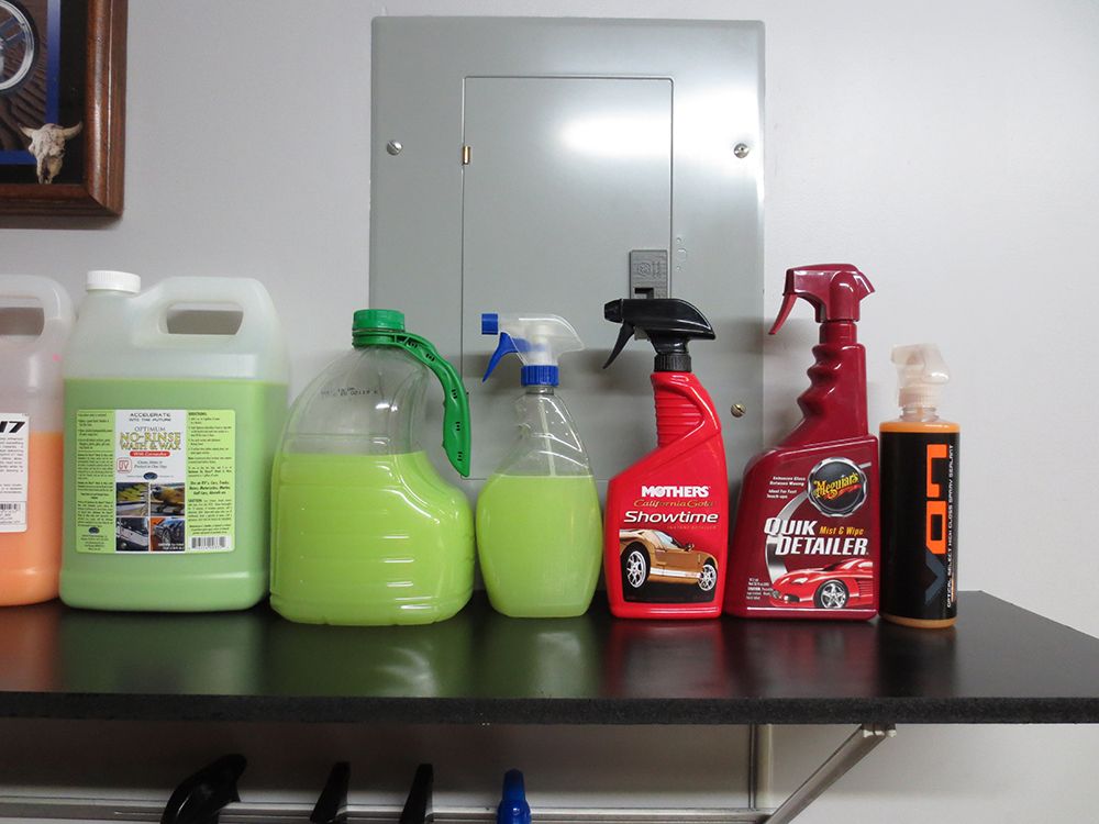

ONR and ONRWW dilution is 1:15 for quick detail. That would be 2oz of onr in a 32oz bottle or 1oz in a 16oz bottle. If you feel the need for a stronger solution mix for bugs 2.9 oz in a 32oz bottle for 1:10
1:15 ONRWW for QD (green mix)
