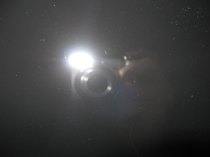

I use it at 3:1 on tires, tried the same on leather, it worked, but is overkill.........here is a 50/50 at 3/1 on leather. After I initially posted, I received feedback that 10/1 works fine for interior.
