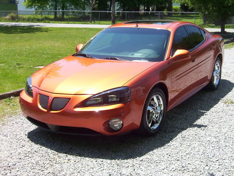

I didn't bother with before pics because this car is always kept spotless,only issues were a few scratches and moderate swirls.process went as follows;
interior-floor mats treated with Folex
megs leather cleaner/conditioner
megs interior QD
stoner's invisible glass in and out
exterior-tires and wells w/purple power 1.1
wash with Dawn
megs clay & QD
XMT 3 w/LC CCS orange (PC 6)
XMT 1 w/LC CCS white (PC 6)
XMT 360 w/LC CCS green (PC 5)
wash megs DC
megs nxt on & off by hand
Mothers chrome polish on wheels and exhaust tips
AA foam in wells and extreme gel on tires
Although it looks much better than it did,it's not 100%.I'd say I removed 80% of the swirls and all the minor blemishes,maybe I need XMT 4 on a LC orange or XMT 3 on a LC yellow,dunno.This is my first attempt at a full blown paint correction so any better ideas,critisism,ect.....let me have it,
Looks good. I think you could of skipped the XMT 1 and went straight to the 360 though.
beautiful first attempt. Using Lake Country pads, try XMT3 with orange and then again with white to break down any micromarring. If you find the durability of NXT lacking, but like the look, move to Megs #21.

thanks,I've always been a die-hard Megs fan but lately pondered going a different direction,I think I'm going to try DP Max Wax next as a LSP

dude that ride looks AWESOME!! trust me you have nothing to doubt about on this job.... that orange blings! hey man if it ain't broke, don't fix it
You have one sweet detail ride there. That orange is kicking!

This picture sais it all to me, this is the altimate test. Direct sun light hitting the paint. Looks sweet, that is one fine looking color my friend. That is great work for being the first one...very nice.
Thanks for sharing, don't question your self you did a perfect job there :awesome:
