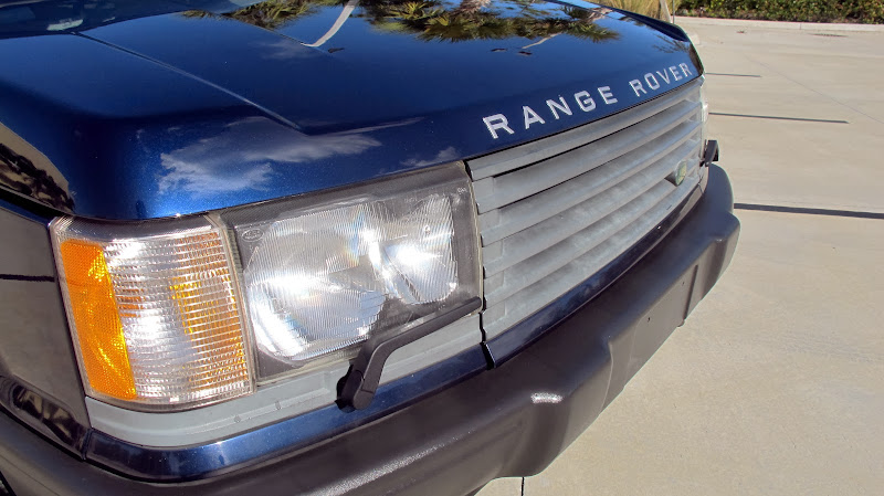

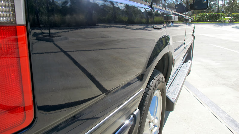

I swear I took before photos... unfortunately, I took them with the memory card not inserted into the camera. The after's will have to suffice.
You don't see too many P38's on the internet being detailed, as people are usually trying to get them dirty rather than keep them clean.
I'm glad that there's at least one unmolested example left in the world.
Process:
Process:
- Wash with Meguiar's Gold Class
- Clay bar using wash bucket soap as lube
- Meguiar's Ultimate Compound applied with Porter Cable 7424XP & Meguiar's cutting pad
- IPA Wipe
- Blackfire Wet Diamond applied with Porter Cable 7424XP & finishing pad
- Surf City Garage Barrier Reef spray wax applied with microfiber towel and removed with a second, clean microfiber towel
- Stoner Invisible Glass on all glass
- Surf City Garage Dash Away for all interior plastic and vinyl trim
- Chemical Guys Extreme Leather Cleaner applied with microfiber
- Chemical Guys Leather Conditioner applied with microfiber (looking for something that finishes less shiny- suggestions welcome).
- Whisk broom for carpets as I was a bit lazy to lug out the vac
- Meguiar's Ultimate Black for bumpers applied with foam applicator.
