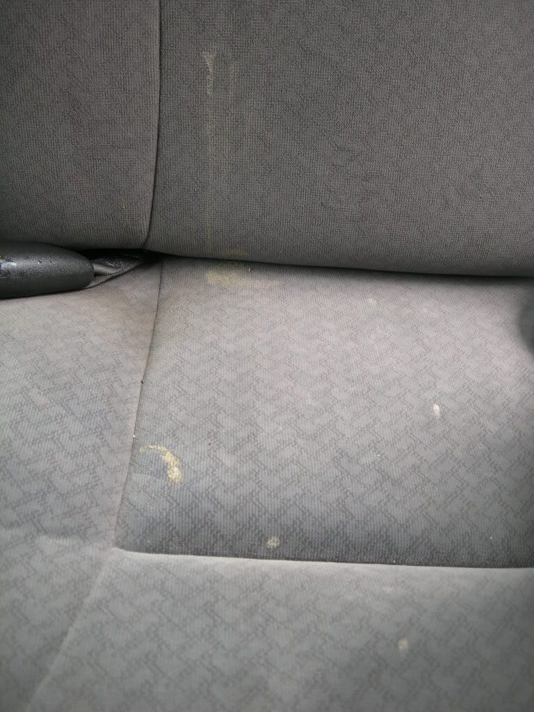

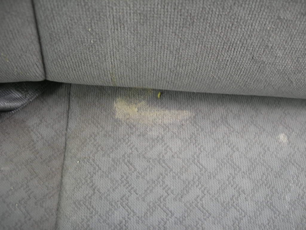

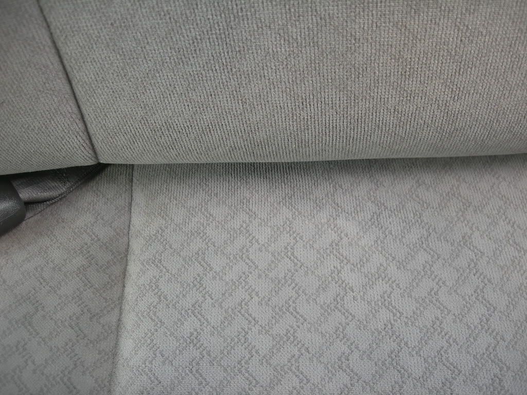

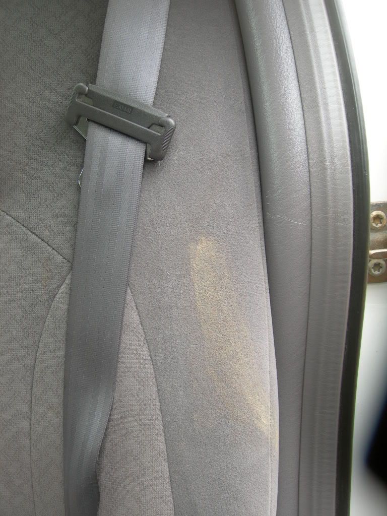

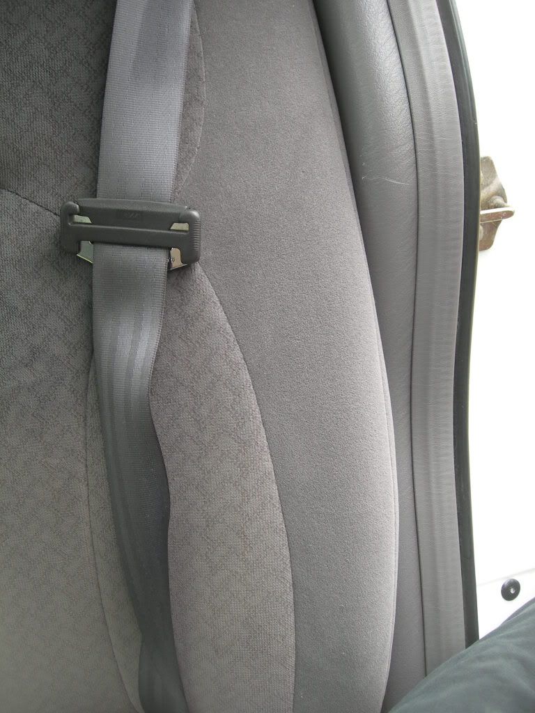

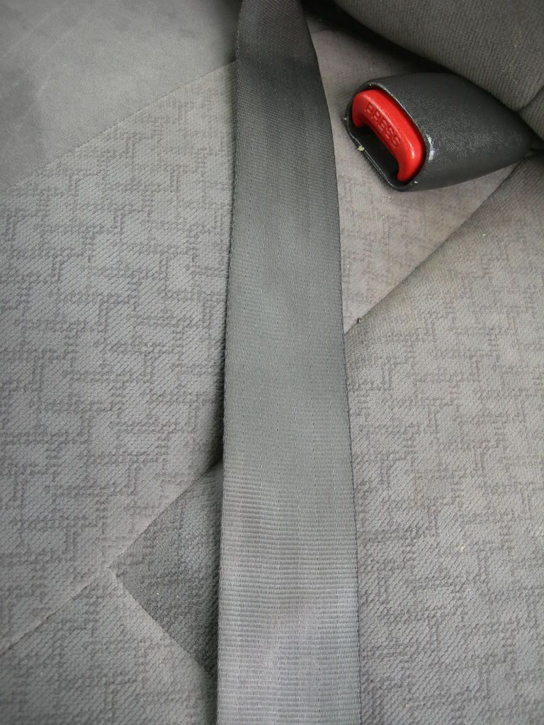

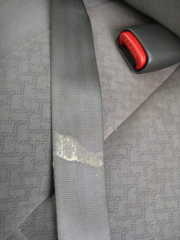

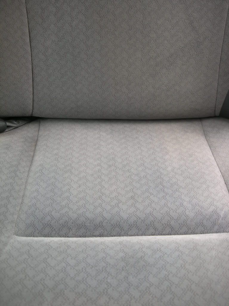

I used some oxiclean on my interior today, worked great. but im wondering if its safe to use? has anyone had any bad experiences with it?
i didnt rinse it out after i sprayed it on, i just sprayed, agitated and wiped with a microfiber. heres some before and afters:

OxiClean is a laundry detergent supplement and is a Bleach product. Why is this? OxiClean contains sodium percarbonate as one of its ingredients. When sodium percarbonate dissolves in water it becomes hydrogen peroxide..Bleach. Bleach has a way of destroying the very fiber of many materials.
IMO...Immediately action needed: You should completely wash out any OxiClean residue and throughly dry those seat-belts--hoping their integrity has not been compromised!
uh oh:P lol the cars not where i am right now, eh ill see how it looks when i get to the car. ill post pics if theres holes in the seats haha

-OxyClean does indeed have soda ash (sodium carbonate--used as a water softner for hard water and aids in removal of its minerals)
-OxyClean also has sodium percarbonate that when dissolved in water turns into a bleach--hydrogen peroxide--that's my concern.

To what extent of using: "OxyClean doesn't do that to the extent that chlorine bleach does" am I willing to accept? I will forgo OxyClean for vehicle usage (especially on seat belts!). IMO...It's a household only laundry-booster bleach product.

Hydrogen peroxide is very short lived when exposed to light, if its been a few hours there's already none left. OxyClean is actually quite gentle. I would bet that most clothing fibers are much more fragile than any automotive fiber. I think you're safe.
I just spent the last 20 minutes googling oxyclean. It's a mixture of sodium percarbonate and sodium carbonate that generates oxygen when activated with water to loosen dirt from the fibers of the materials. The process is similar to using hydrogen peroxide to cleanse a wound. I'm no chemist, but nothing I've read indicates it would do fabrics any harm, except that it's not recommended for pure wool or some silks.

yeah i just checked the car and everythings fine...haha
