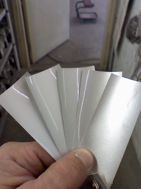

under the same paint code there was probably 4-6 if not more different mixtures to get that code. what i mean is if you were to look at the same 2 cars with the same paint code they will be different if the paint was not from same batch. if you find another jeep with your same paint code i bet if you sit them side by side you would think they were different colors.
to give example of what i mean i took picture of a set of paint colors from work. there are 5 different swatches but all are same paint code.
dont think the picture shows it but there is a difference in all 5 colors. and as you will see from the next picture they are all the same nissan paint code
you notice there is a letter after the color name. that is where alot of problems come. some shops may not pay attention to that. and it will make a world of difference in the color. all 5 are the same manufactures code (KL0) also all the same name (silver ice) and all from the same year (1992) which is why touch up paint you but in stores or even from the dealership does not match. to many variable within the paint code
