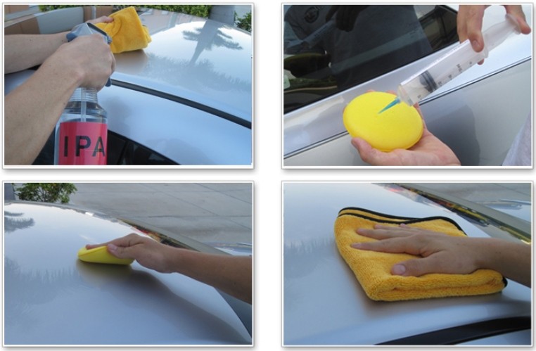

Try using rubbing alcohol and wiping it with a microfiber towel.
