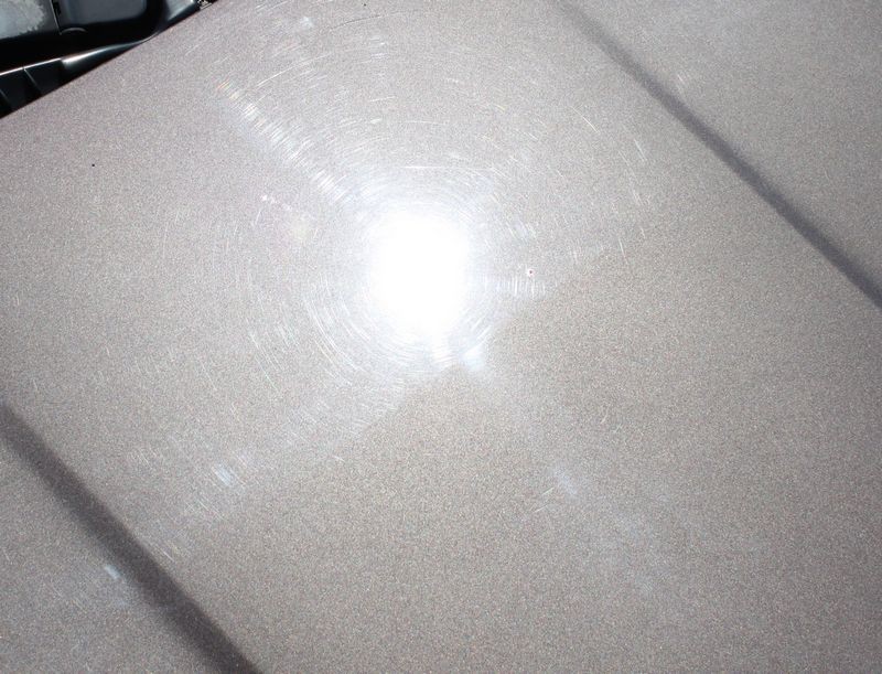

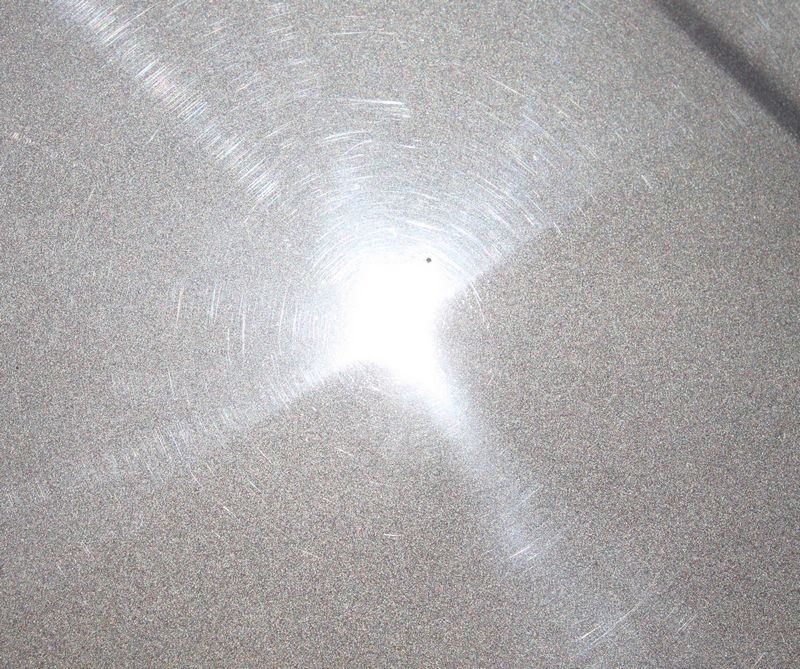

Chances are good these are tracers...
Tracers Tracers - RIDS - Pigtails - Cobweb Swirls - Rotary Buffer Swirls - Holograms - Water Spots - Bird Drooping Etchings - Micro-Marring

Are the straight line scratches in the direction you moved your hand when you sanded?
One way to tell would be to use the same microfiber and wipe in a different direction than the current straight line scratches, if you see a new scratch pattern then you know it's the microfibers.
Sanding marks are best removed using a rotary buffer, using a DA Polisher could mean what you're seeing are Tracers as you'll remove the shallow scratches first and what's left are the deeper, sanding marks.

Troubleshoot and determine if the straightline scratches are sanding marks or toweling marks, my guess is they are Tracers. If so then either a rotary buffer with a wool pad or foam cutting pad and or a Surbuf pad on a DA Polisher.
