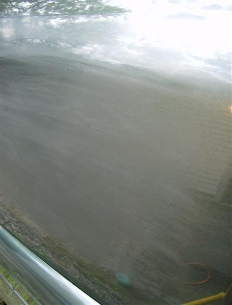

Poorboy’s Pro Polish is one of the most underrated detailing products on the market. It is a chemical cleaner that can clean the paint before your sealant or wax, it’ll clean chrome, glass, metals, plastic, etc. It’ll do everything. It can even remove wet sanding marks. Pretty impressive for a chemical cleaner!

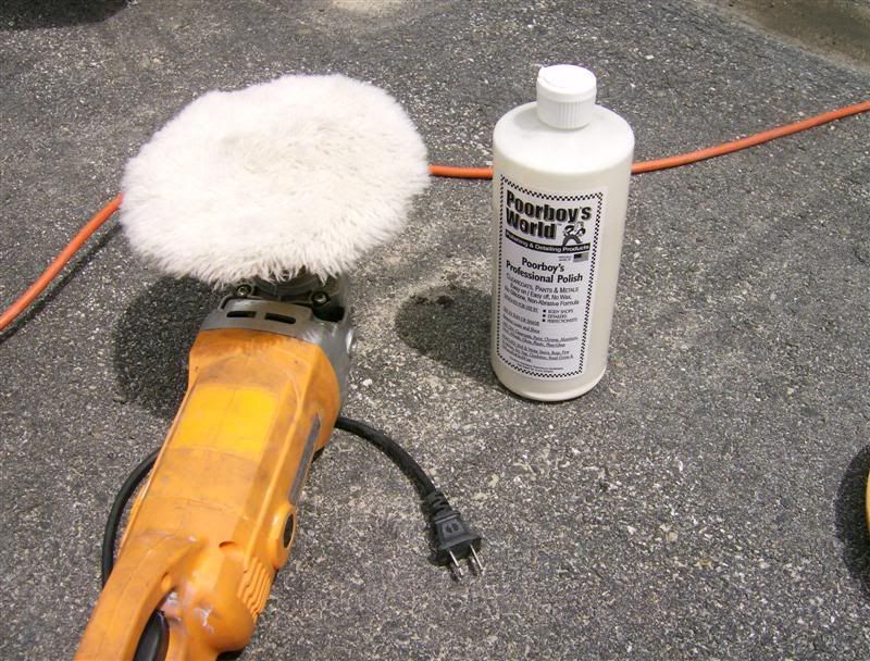

So to clear up any misunderstandings that a chemical polish can’t remove sanding marks, I decided to do this test. I went out to my Dad’s company car with my HF rotary, a wool cutting pad, Poorboy’s Pro Polish, a few MFs, S&W and 2000 grit sandpaper. Just a heads up that the pictures are not that great… the sun was playing tricks and halogens and the Brinkmann don’t show swirls that well outdoors.
The main event:

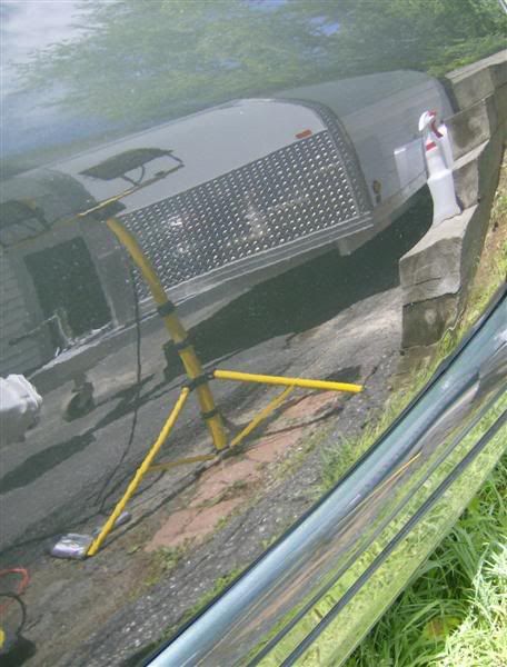

Before… there are swirls in there…
Sanded down:
Cutting tools:

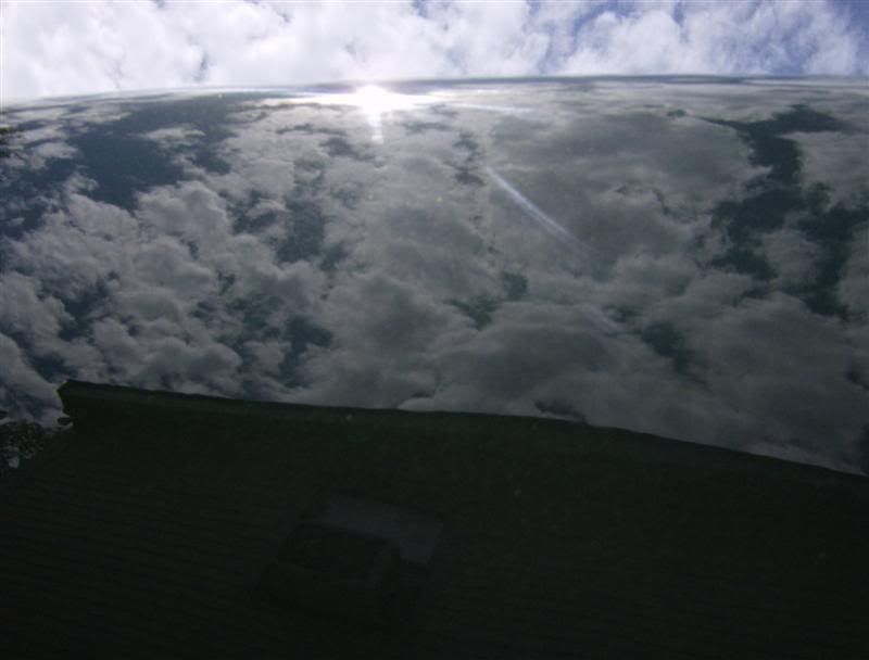

After 1st pass:

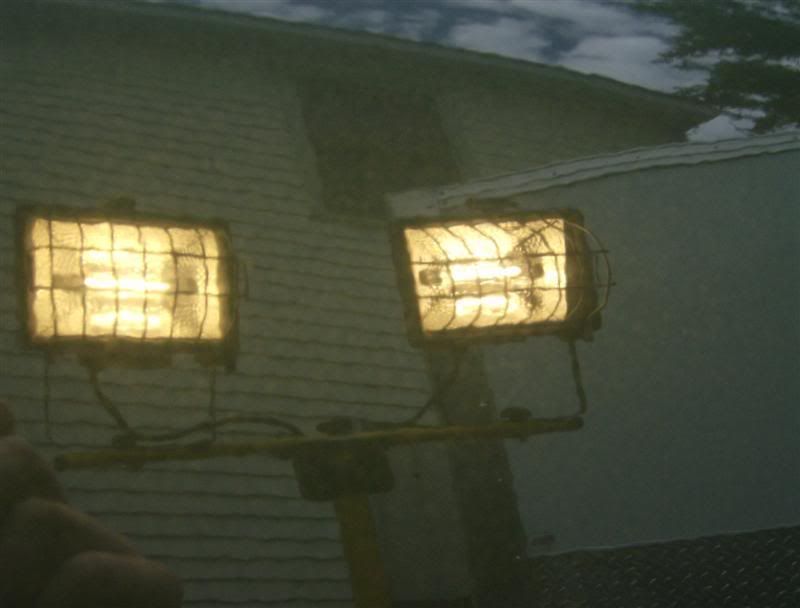

After 2nd pass – alcohol wipedown (notice beading!)

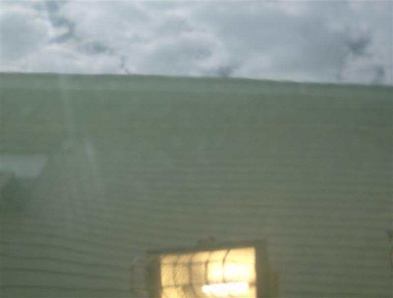

All sanding marks gone (a few holograms though):
After some Optimum Polish and polishing pad to clear any holograms = finished results:
So there you have it… a cleamical polish removing sanding marks. As I said above Pro Polish is very versatile and if you don’t want to use it as a defect remover you may want to look into using it as a paint cleaner. To show it’s fullest potential I wrote on my Jeep with a Sharpie, let it dry and then proceded to remove it with PB PP:
So this is my latest test with pictures. Hope I helped you understand a product you may not have tried before. I will admit that I don’t use PP all that often but I need to work it into my regime in the future more because it is simply a great product!

I truely believe that this is the most underrated detailing product on the market. It'll tackle any situation that you throw at it! I have to be honest, I was a little scared writing on the Jeep thinking that it won't come off... but it actually wiped off like a dry erase marker! PP is also great at cleaning the paint free of oxidation and cleaning up chrome.

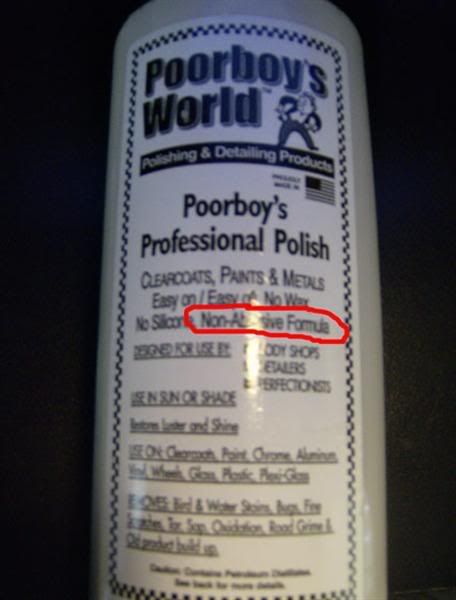

impressive ... would like to hear/see how Steve suggests how the product actually works. Obviously pad is providing the abrasiveness, so is the polish doing the work or is it simply the lubricant allowing the pad to do the work ??

My understanding is that Pro Polish works best as a paint cleaner. But since the product is so versatile it also lubricates any type of pad which lets the pad do the cutting. I guess the heat that a wool pad & a rotary generates enough heat plus the cleaning power is what actually removes the sanding marks. Since there are no diminishing abrasives in the polish, you'll be left with any micromarring from the pad if you go really aggressive. It is easy enough to bump to a less aggressive pad and finish up though.
Some of the other uses that people have found include adding gloss to the paint before LSP, clean up oxidation, fix cloudy headlights, polish up brass, polish jewelry (cough Lauren), stainless, chrome, glass, and I'm sure you've figured out that the list can go on and on.

You should try it with a machine sometime if you are looking to try something new. I used a little too much product to begin with so I had some splattering but that was the only issue. I went over the panel twice and worked them in for less than a minute both times... never really counted how many passes I did. I am no professional with a rotary and don't have that much experience with wool pads so the holograms were inevitable for me. It definitely didn't dry out fast though... plenty of time to let the pad cut through the marks. I personally like a product that I can pick up and do more than one task.
