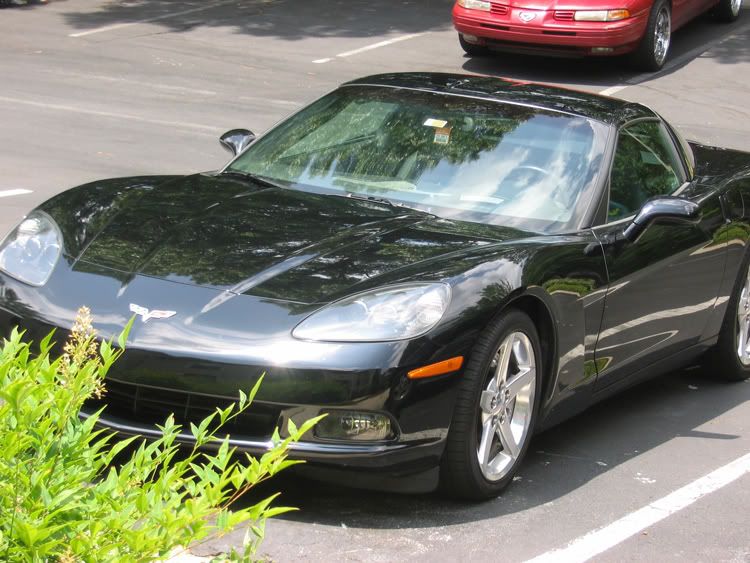

The patient
A 2005 black corvette

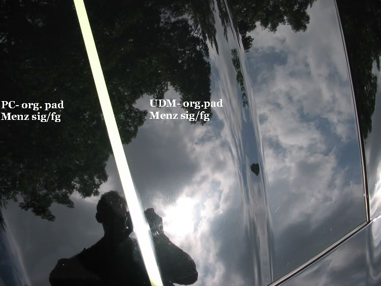

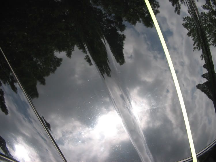

The left is was the PC and on the right was the UDM

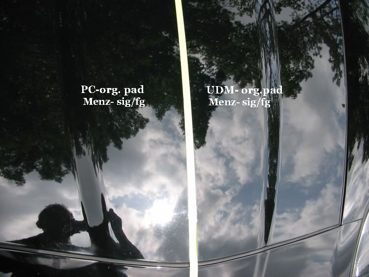

You can see that the UDM side reduced the cobbwebbing alot more.

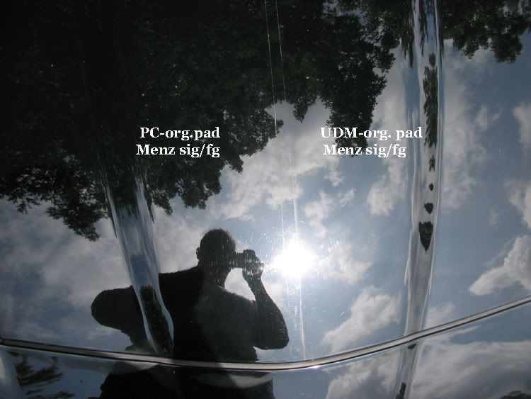

Tape removed you can see the difference in the two side

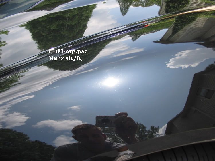

The hood needed some extra work, compared to the rest of the body
The aftermath
Looks like a great tool
Also looks like the Menzerna likes some more "bite" when applying
Could fast be a hit combo
