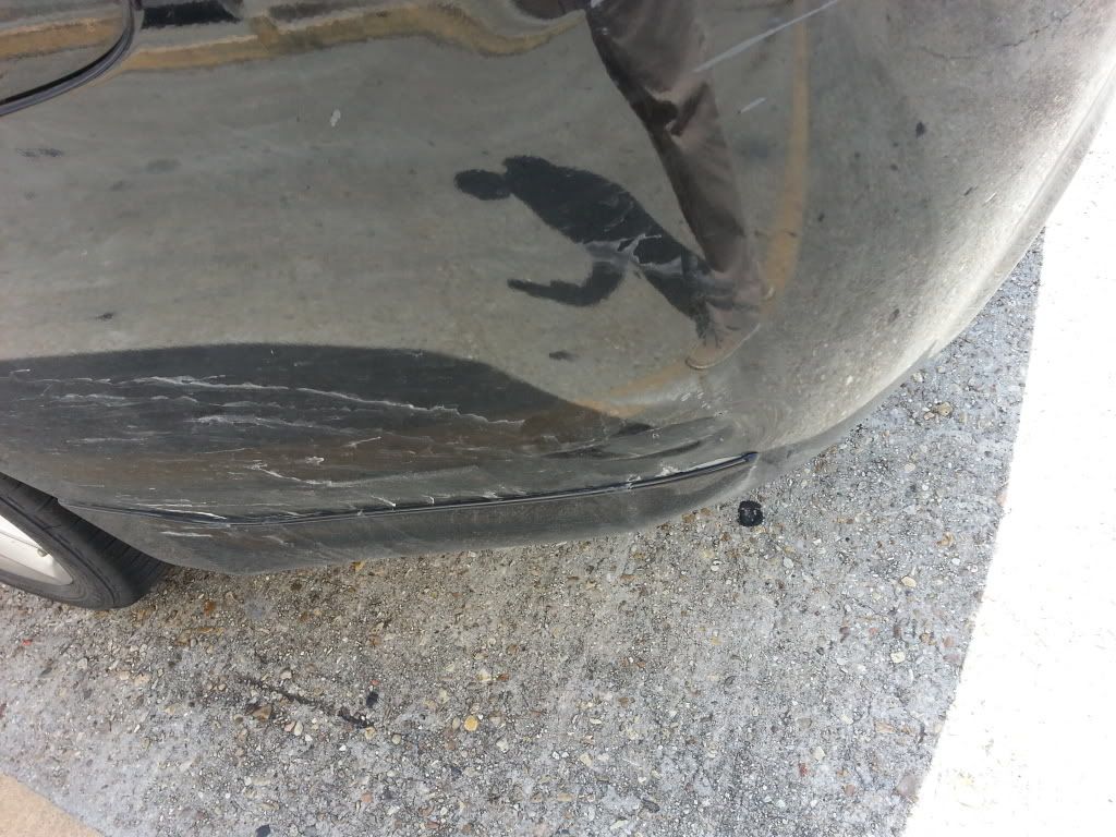

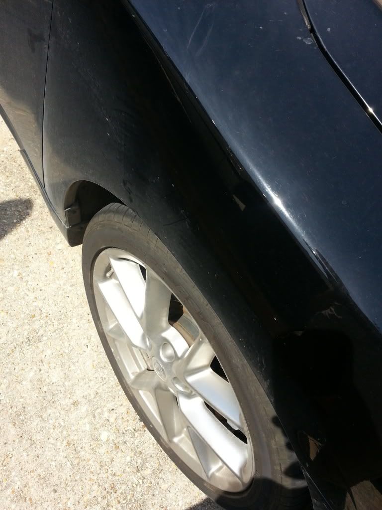

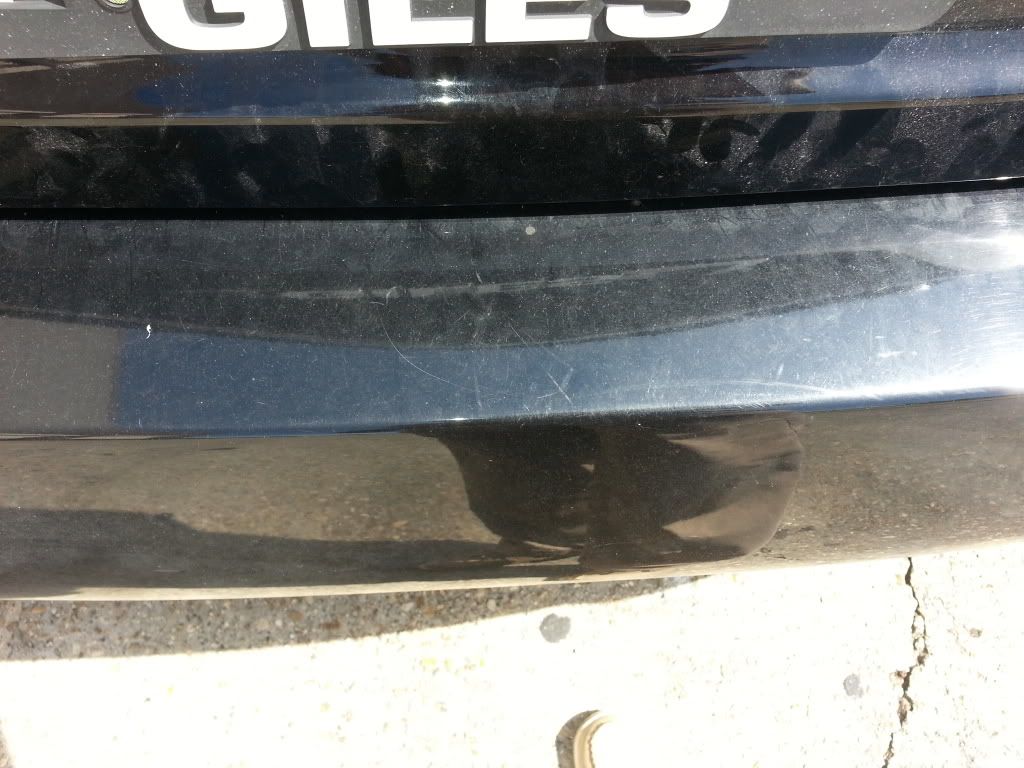

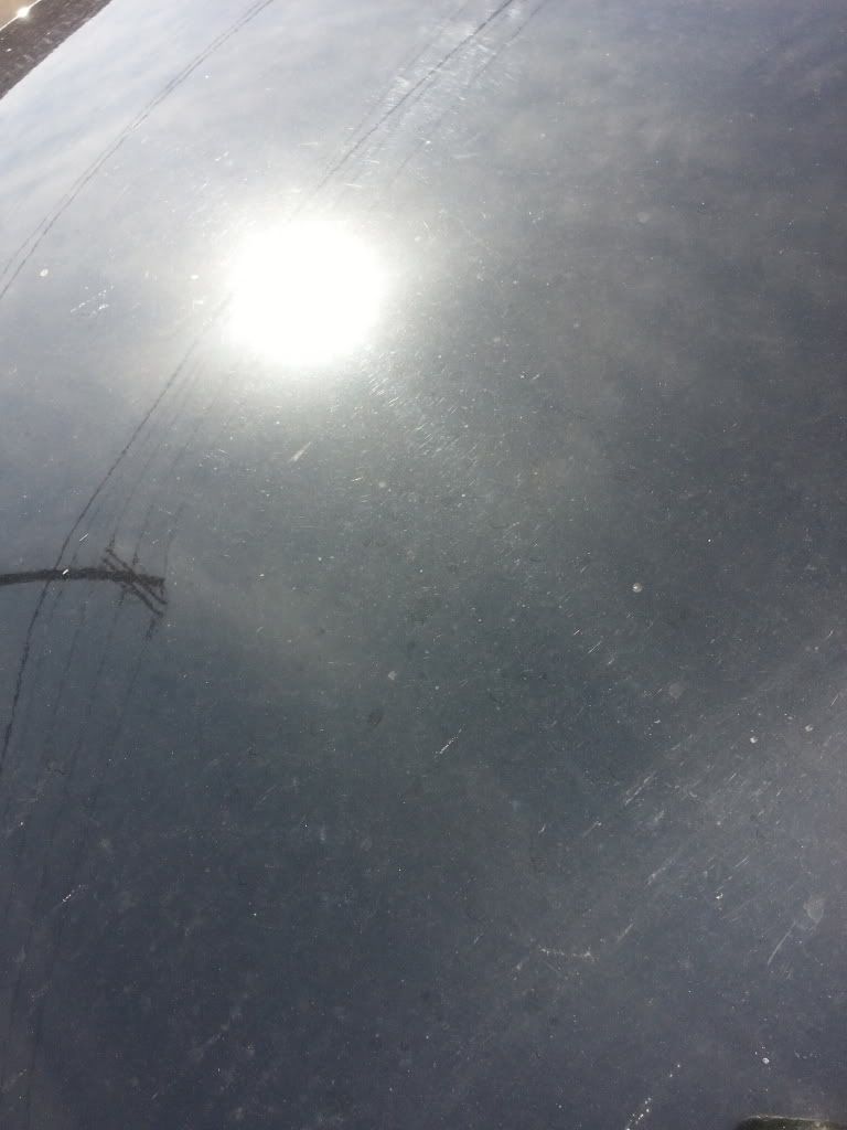

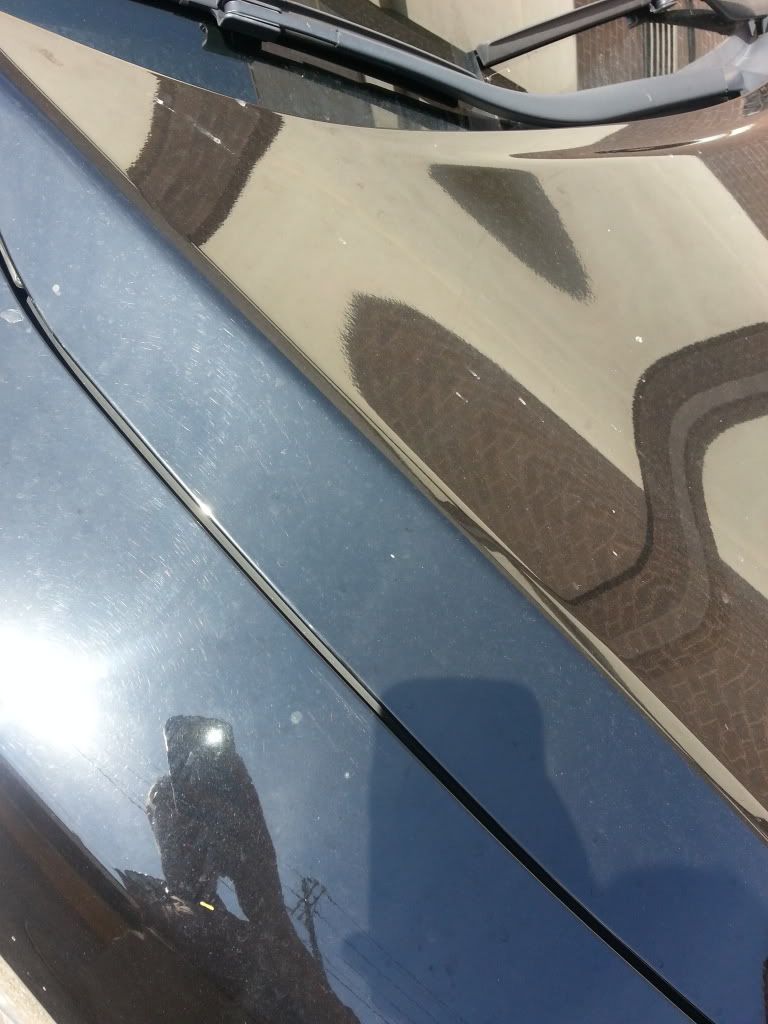

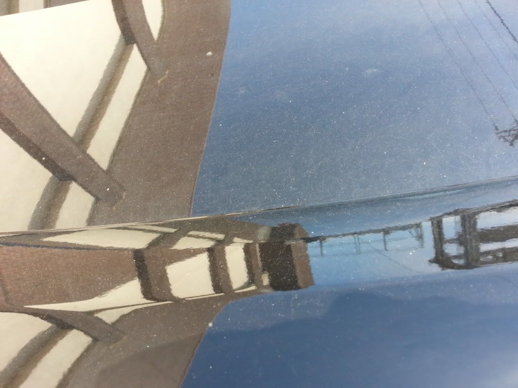

I picked up a black 2010 Maxima,the pictures just doesn't show how bad the finish really is.
Paint is rough, swirls beyond belief for only being three years old, early signs of oxidation.
I'll start on it tomorrow, the wheels are also terrible.
Will try to correct it in 2 days but might take 3 days to get it like I want it.
Few pics below

I clayed the car last night, can't remember the last time I had one this bad , serious over spray.
The paint looks dead to me, I'll have to really compound it well before any polishing is to begin.
There is zero protection on this car, it's ashame that someone would let such a nice car go to crap.
I'll first try my v34 along with CG's MF cutting pad, if that doesn't work for me I'll then try m105.
You can really see the damage since I washed it and clayed.
