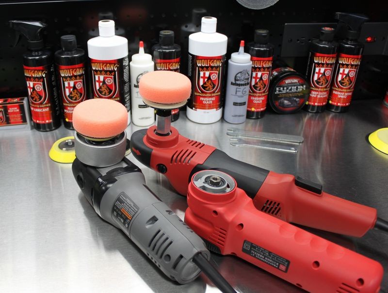

I call these Peanut Polishers because they make me think of Peanut Grinders and Peanut Grinders for those that might not know are not for grinding peanuts but are small hand held grinders for grinding steel.
What we're using the Griot's 3" mini polishers for are to machine wetsand using Trizact 3" sanding discs by 3M.
Two reasons why...
1. The 3" diameter of the sanding disc works perfect for sanding thin panels and for getting into tight area.
2. The 3" polishers are small, lightweight and compact. This makes them PERFECT for people just starting out and learning to wetsand by machine. Because they are small, lightweight and compact in size they are incredibly easy to control and this is important when sanding on someone else's hotrod or any project.
After sanding with a small size tool like this and getting some experience as to what it's like to machine wetsand paint I then move guys up to the full size dual action polishers and the 6" discs.
Like the old saying goes...
We all learn to walk before we learn to run...
So these small sanders are great for sanding thin panels, curves, tight areas and for learning the art of machine wetsanding...
