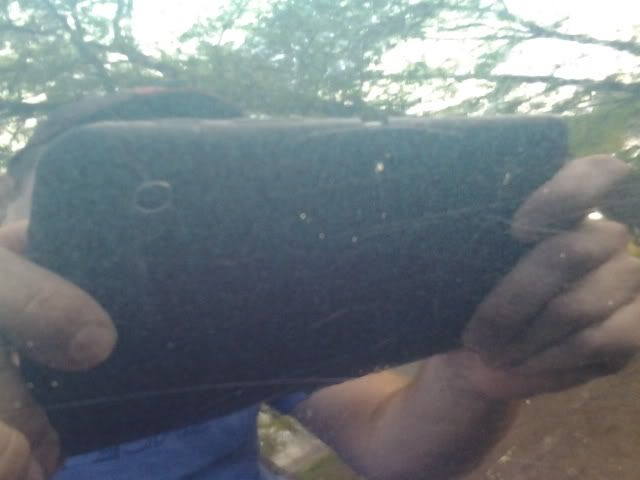

My car has some light scratches and swirl marks that I would like to get rid of, I guess I want to do a paint correction.
Here is a picture of what I am dealing with

I tried the orange pad and the 3M compound last night on a small area but I did not have any luck. Will this 3M compound do the trick if I get a different pad? I saw in another thread were someone recommended the Surburf R sereis Pads for Meguiras M101 or Menzerna PG1000. Would that be a option for me with the 3m compound?

You should look into Menzerna FG400 or M101. If those are too much for you then you can look into M105. If nothing else had worked for you then stepping up to a good compound will be next. If you go with either of those you will want to follow that up with either Pinnacle swirl remover of BF gloss enhancer polish. Then top with the sealant you have.

I'd say you need to check your technique and dial it in because, imo, that 3M rubbing compound along with an orange pad on speed 6 with the pc should have no issues removing those scratches. The only thing left to critique then would be arm speed, and pressure. Buying more products won't fix this issue in my opinion because you already have quality products.

I washed off the sail panel on my car which is where the picture I posted is from to do some more experimenting. I tried the 3M compound with my orange pad with the DA on 6. I had to apply a lot of pressure but I got most of the scratches out of it after 3 or 4 applications. I stayed away from the edges, I guess I need to tape them. I guess I need to get a yellow pad and a microfiber pad and experiment.
