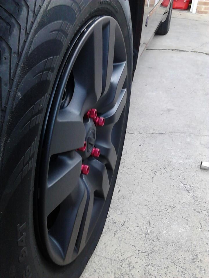

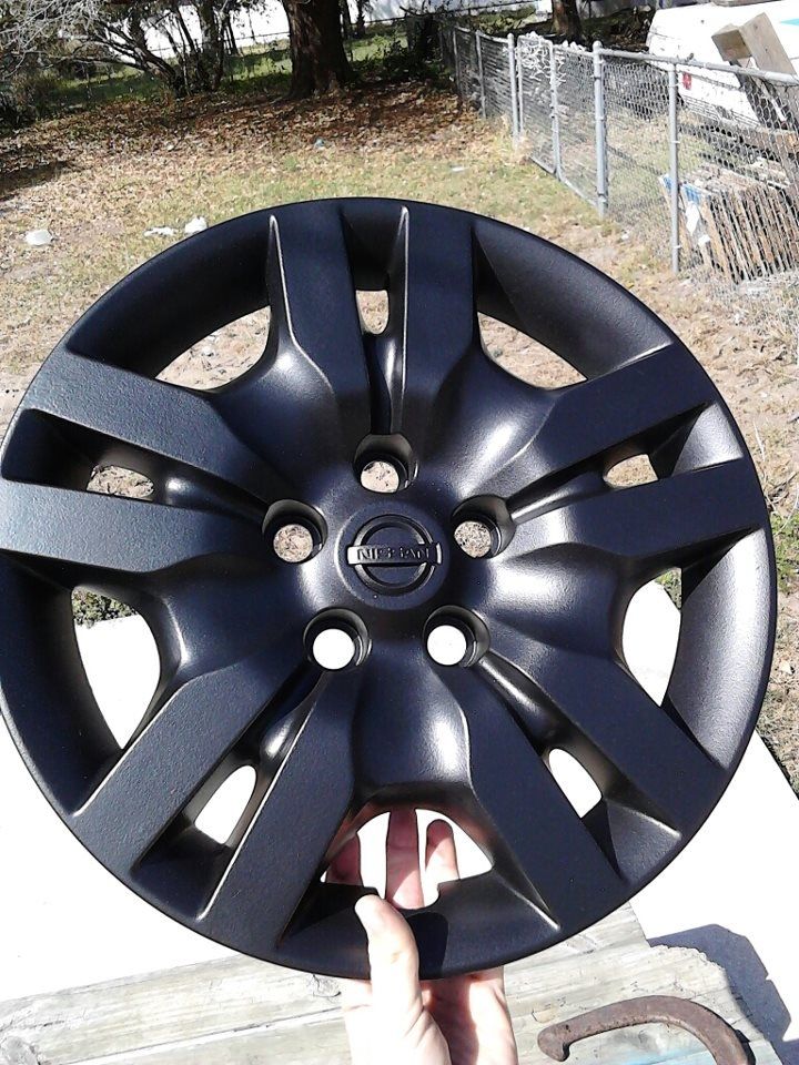

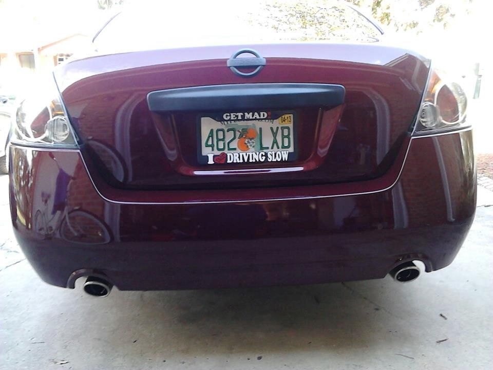

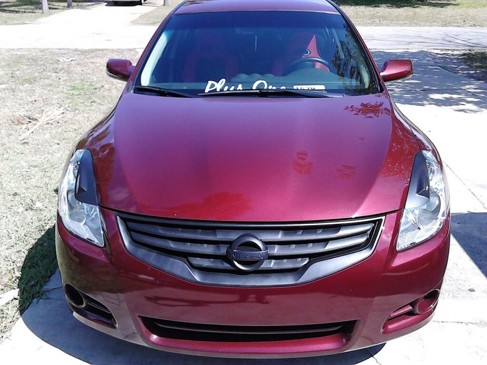

Pictures of When I Plasti Dip my Trim, Emblems, Grill, and Wheels.
Before-
After-
Hope this helps. Good luck!
