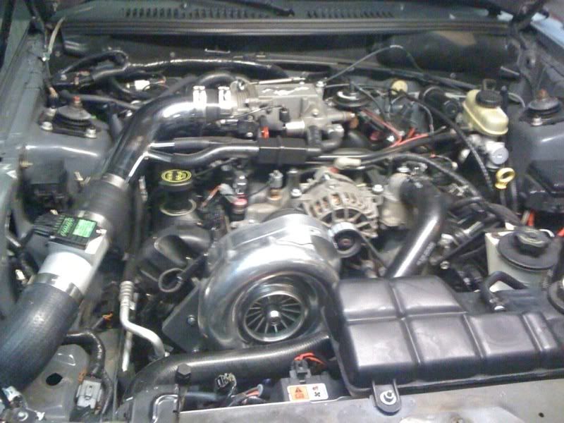

Pretty cut and dry question...
What process/product to polish the ProCharger on my Mustang?
It is a polished part so I assume some sort of metal polish and some elbow grease is in order. Just seeing if yall had some tips/products you would recommend. Just don't want to screw it up lol.
Here is a pic for reference...
It has been in and out of the car a few times, and is looking a little rough on the finish. Just trying to shine her up for show season.

I've used the Mother's power ball on some polished parts and it works great. I don't think that it will fit in all the nooks and crannies around that turbo though.

Me? I would tape the prop up and and give the Mother's Aluminum polish a try. Obviously a buffer will not fit down there, so bloody knuckles it is.
A quality aluminum polish and the PowerBall Mini (that 10" extension will really help) and the PowerCone (use the extension on it, too) will get most of the area on the ProCharger.
I polished my Vortech on a regular basis and it wasn't much work at all. Biggest thing will be to keep water spots off it if you run through rain or clean under the hood.
Taping off the adjacent areas is a good idea.
I have some Mothers Polish, probably give that a try on a small area and see what happens.
And yes, no turbo here. Boost comes in very similar though on the power band. It's a P-1SC, 3 core IC'd, Power Piped, PMAS BlowThru, etc, etc.
